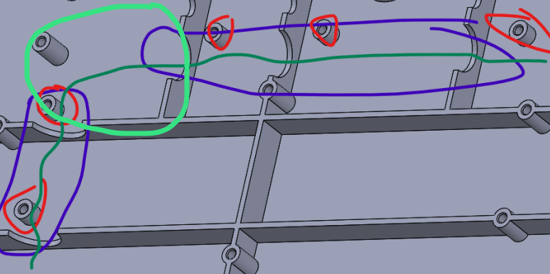

In my attached IMG green shows the planned route for a roughly known quantity of ribbon and other cables. I want to put heat-serts in the red and screw in cable clips (already have a bunch from something else). The blue circled 'scallops' I took out of the ribs to allow the cables to pass through as well as guide them somewhat. Essentially I'd like to know if what I am doing is sensible here or if I need to really rethink how and why I'm doing these things.

Its workable for your cable routing design, just need to pay attention to the cable bending radius in below area.

Threaded inserts for cable retention clips seems rather luxurious. Take apart most consumer electronics and you'll find self-tapping screws or push-on clips over a molded pin.

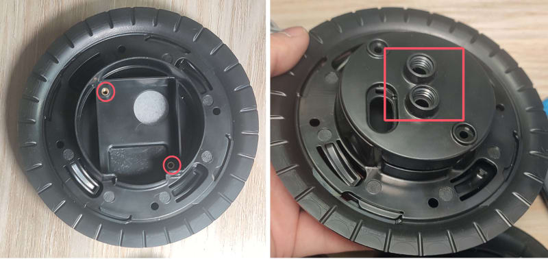

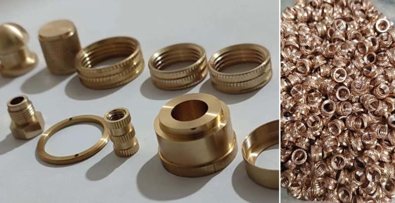

Two options, one with thread inserts for small holes to ensure strength and easy to inject, another for larger holes with threads injected directly.
Cost of thread inserts will not be much higher than 2nd one, if quantity is not less than 1000 thread inserts, because thread insert can be produced from turning and milling composite machines, faster and cheaper.
