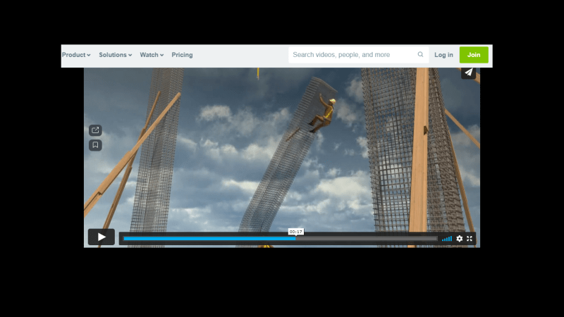

This respond reminds me a video of collapse of rebar tower...
Link =
