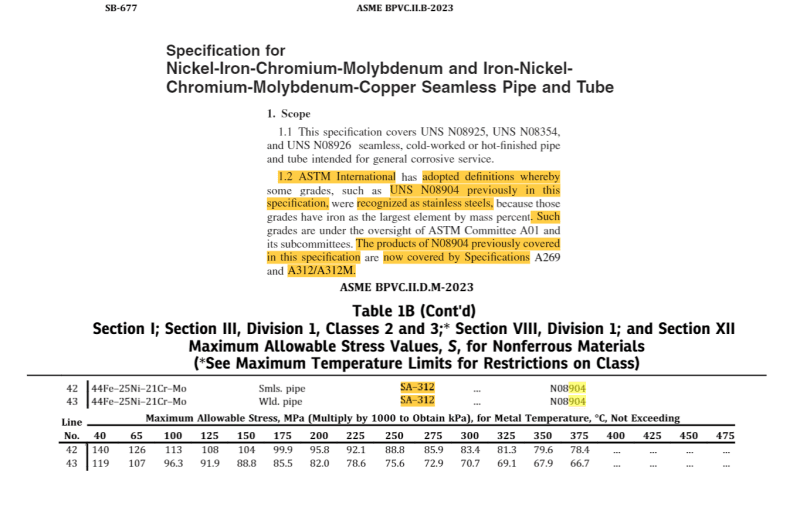

Hi, experts,
I am currently working on a Shell and Tube Heat Exchanger (STHE) design with the tube material specified as SB-677 UNS N08904. Table UNF-23.3 lists SB-677 UNS N08904, but I can't find the allowable stress values for it in Table 1B of Section II, Part D, Subpart 1. Does anyone know where to locate the allowable stress for SB-677 UNS N08904?
Thank you!
Refer to Section II-B, SB-677, Paragraph 1.2, this product is now covered by Specification A312.
So, you may use the allowable stress per Section II-D, SA–312 for this grade.

Thank you for your suggestions. However, I think using SA-312 pipe material for tubing is inappropriate due to the wall thickness. A possible solution is to use the SA-249 N08904 welded tube specification, but based on our previous project experiences, seamless tube would be the top priority. Another option is A-269, but UHA doesn’t adopt A-269. Is there any Code case that allows for the use of A-269? Or is there a clear path to design an STHE with SB-677 N08904 tubing when using ASME BPVC 2023 Edition?
Furthermore, in the 2021 Edition, the Code does provide the allowable stress for SB-677 N08904, but this was deleted in the 2023 Edition...

@leon_hr_dt, according to Section II-B, SB-677, Paragraph 1.2, this product is now covered by Specification A312, not 213.

Working with the code means be precise and read the code. Which edition is applicable?
Edition 2021
SB-677 UNS N08904 is mentioned in table Table UNF-23.3 as well in ASME IID, table 1b, line 37 and UG-4(a) will be met.
Edition 2023
SB-677 UNS N08904 is mentioned in table Table UNF-23.3 but not mentioned in ASME IID, table 1b and UG-4(a) will not be met.
Summary of change in ASME IID: Table 1B (2) Lines 36 and 37 deleted.
This is an inconsistency that has occurred several times in the past. However, as I have already mentioned, the UG-4(a) is not formally satisfied.
But you can use UG-15
"When there is no material specification listed in Subsection C covering a particular wrought product of a
grade, but there is an approved specification listed in Subsection C covering some other wrought product of that
grade, the product for which there is no specification may be used provided:
(a) .......The stress values for that specification given in the tables referenced in UG-23 shall be used.
