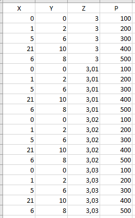

Hello,
I have pressure data in excel in the form of (x,y) coordinates and pressure magnitude, pressure will be applied in one direction only. I would like to "project" the pressures onto the 3D surface without considering the z coordinate of the nodes. There must be a way to do this, likely using a data surface. Does anyone know how?

Use "Arbitraty 3D Data Surface". Create two sets of points with Z1 and Z2 coordinates that your model stay inside these points.

Actually I tried to interpolate pressures in the test case and noticed that the results are not very good. Better not to use my previous advice.
I have some thoughts on how to elegantly solve this problem but I need some small and simple test examples from you. I need a surface, mesh and table with points to interpolate.

This is true but if we consider the worst scenario: non flat surface and random number of points instead of four values at corners.
In this case ve can not use Parametric table or Along coordinates.
Here is another variant:
1. Assume that our surface has Z coordinates between z1 and z2.
2. Prepare in Excel table. Write all data points and x,y coordinates. Use z1 as Z coordinate.
3. Copy these cells to the end of the table and change Z coordinate to z1+1mm or other small value until you reach z2.
4. Load this cumulative table into Femap as Arbitrary 3D Data Surface.
Now we have Spatial field of variable and if we interpolate values in any point inside this field, result vill be almost insensitive from the Z coordinate.

If I understand correctly we have only X and Y coordinates and have no info about Z coordinate and we have some random non flat surface with mesh. Interpolation takes into account distance from data points to elements or nodes. Now if you place the Z coordinate far away from the actual position (Z>>X, Z>>Y) of the node or element then all of the data points will have almost the same distance and interpolation will give wrong results.
