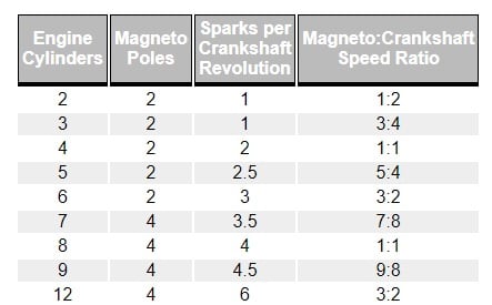

That chart right there says a lot.
I'm going to the same type of 4 and 6 mag tonight... pretty sure they use the same rotating magnet,coil,cap... if that's the case that table shows that 5 cylinders are still just using 2 poles, then the rest should just be some gear box mods.
Someone had told me a year or so about that the speed of the rotating magnet could really mess with the frequency or something. I have no idea if they knew more or less than I do.
