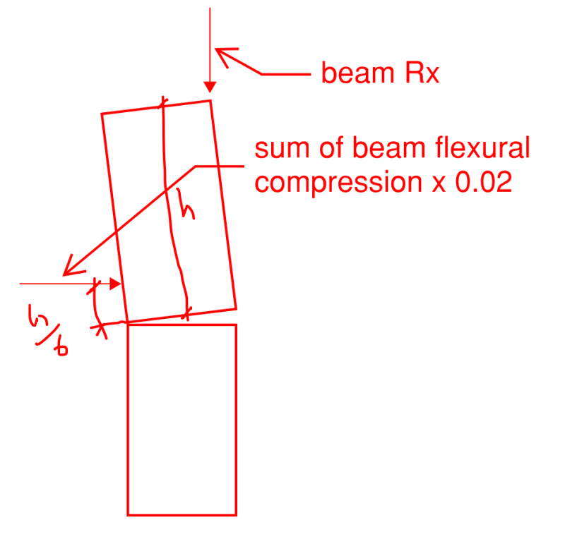

My very strong suspicion is that no connection between beam and post is required for LTB restraint in many cases. I suspect that the gravity load pre-stressing of the joint gets the job done so long as the beam is of sufficient width and has full bearing from below. I've been tinkering with various ways one might prove this analytically but its probably not something that you'd want to hang your hat on considering the source is just some cyber-nutball. I think that there's precedence for this though. I've seen a lot of historic buildings where very stocky looking beams seem to survive on this very principle.
Lol well judging from your threads you have plenty of experience and I think that makes sense. It is a 3-ply beam which gives the beam a total width of 5.25". The two spans are approximately 10' and the beam supports two floors. Trib width on first floor is about 13.5 ft and same for second floor. No roof load as trusses span the entire home.

This is a very poor man's version of what I eventually hope to do with the pre-stressing model that I proposed. It's predicated upon detailing that would cause the joist members to rise with the beam rotation as shown. In this way, I hope to quantify the question of "how wide is wide enough?".
My feeling on this is that, if this pre-stressing mechanism were overcome. We probably would see distress in a lot of our common post to beam connections. Under beam rotation, both the saddle and screw solutions would tend to create tension perpendicular to grain at the bottoms of the beams.

There's also the fact that the beam/column connection also provides positive restraint through lag screws or such, restraining the rotation in KootK's sketch even more. I don't know if I'd seal a design utilizing the concept yet though.
