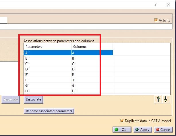

Is there any way to just look at the each association
between parameters in CATIA and ones in Excel by VBA?
Parameters mean userparameters I defined
thanks
Thank you for your kindness.
I checked the macro script but it is only used to links an excel table with a design table.
I want to see the each association which are already linked like perameter "D1" in CATIA linked "D" in Excel.
thanks

Specifically, I want to see the accosiation bellow picture by VBA
Thank you for answer.
I don't need to open the window like the picture.
I just want to watch the association through some properties.
(A is associated with A, B is associated with B)
As far as searching, there is no properties which have the association(excel parameter name).
thanks
I got what you want, and I was refering to the original thread request. Same answer - not possible in Automation. Look for non-programming workarounds.
