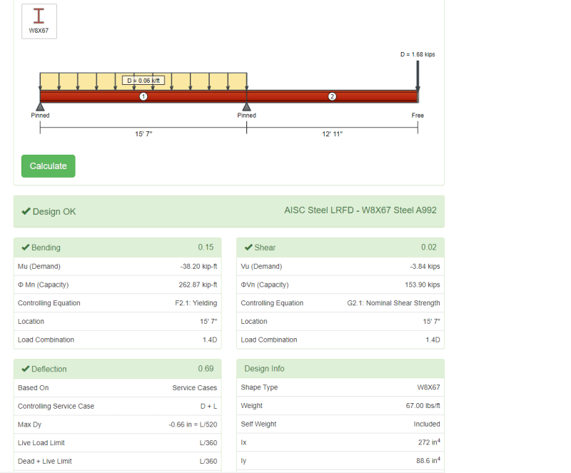

Hello all, this is my first time posting here so apologies if this is formatted wrong.
I had a couple questions about a beam I am currently analyzing that has a large cantilever section and had a few questions
*UDL of 0.31 kip/ft is a snow load
*UDL of 0.35 kip/ft is a LL/DL
*Point load of 1.42 kips from joists running parallel
All loads are factored
1) I am worried about the resulting uplift of force on the left support from the total load on the beam causing some sort of teeter totter effect , am I correct in assuming this is a concern?
2) What can be done to ensure this left support does not fail from the resulting uplift?
3) Can cantilevered sections operate safely at this span length?

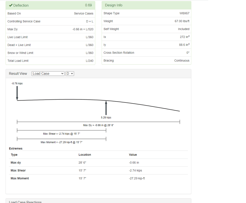

Yes I have the new beam with DL on left only (0.9 factor) and a live/dead point load from bathroom (factored) only.
see attached
as you can see there is about 800lbs of uplift force on the beam in this worst case scenario.
I disagree that the deflection of .66" is L/520. To me, you should use the 12'-11" = 155" as your "L". Anyone standing near the left support and looking to the right will see a gradual uphill followed by a sharp downhill.

Ron247 the 12'-11'' span has the joists running parallel therefore not picking up a UDL and instead picking up a point load from another beam at the end (1.68 kips).
