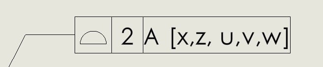

Below is a screenshot of the datum features/simulators of the part/jig to try to make the above more clear, and a set of planes that represent what I want to try to create. I've had to delete the part outside of the jig points for IP reasons. I've left the jig solid and the part transparent for clarity. And I've zoomed in the individual parts where the part sits on the jig also for clarity.
Can you guys see a way to make this work per the standard via GD&T? Is doing so a non-issue? Or is it an unsolvable issue?
Label each one as a datum target A1-A6. The 3-2-1 is for planar objects. A cylinder as primary covers 4 degrees of freedom, an irregular surface can control 6, a flexible part that is constrained may have many more than 6.

One more question,
I've established a datum reference frame using my 6 datum points, shown the axes X,Y,Z in two views to make it explicit, and now I need to decouple some of my tolerances of profile from one of the axes. For example, I have one complex surface that needs to be free to move on the Y axis. Is this a simple matter of explicitly not calling that axis within the FCF?
That is the way it is to be used.
