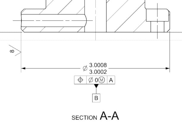

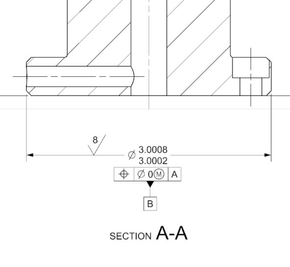

Greetings,
I know the drafting standard says to attach a finish symbol to the extension line of the dimension, but the consensus of the younger folk is that the symbol attached to the dimension line is more clear and easier to read. We don't adhere fully to any particular drafting standard, and I think the option of having the symbol on the dimension line conveys part intent (meaning a vendor should be able to understand what is needed to make this part). I was wondering who would give this drafter a hard time, or who would say "who cares as long as part intent is conveyed"? Or maybe another option?
Images are of a section of a cylindrical shaft with the finish symbol in 2 different locations.
Thanks for your input.

Thank you, and I am familiar with the standard.
But, like I posted, we don't follow any standard to its fullest, so I am wondering if the symbol on the diameter line would convey the wrong intent?
I prefer the top view, but did understand that it was the 3" diameter that the drawing wants held to a 8 finish.
It conveys confusion. Write for the audience.
I prefer it tied to the extension line, seems less ambiguous.
Unless you are going to document this interpretation, I would stick with accepted practices.
