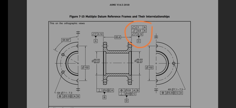

Hi
What is the meaning of circled FCF?
Profile tolerance itself control the orientation within 1, then again refining // 0.5.

Hi All,
As usual, I agree with pmarc. If the feature was an arc-shaped or other curved surface, then the orientation control could not be achieved without using composite profile.
It's easy to show that the committee intended to apply composite profile to a single feature - the first example in the Composite Profile is literally titled and described that way. Unfortunately, the "feature" that they chose isn't really a single feature ;^/. It's a pattern, whose tolerance zones are grouped by the all-around symbol, which is a grouping mechanism but wasn't described as such until 2018. But that's a whole other story.
I don't see any reason why composite profile cannot be applied to a single planar surface. If we were to do that, the meaning would be clear. But I would agree that it should not be, because the combination of a profile tolerance and an orientation tolerance would be more straightforward to understand.

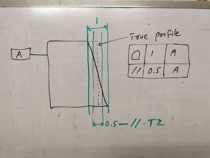

Parallelism of each line element wrt A is not the same as profile wrt A in the middle segment of the composite callout.
Because there is no form control by parallelism of each line element as opposed to profile wrt A in the middle segment?
I agree, but the form ends up being controlled to a tighter tolerance in both options (by cylindricity or the last segment of composite), and thus profile in the middle segment effectively only controls orientation so what's the difference at the end result?
Or did you mean something else?

I think what pmarc means is that controlling the parallelism of the line elements only controls the orientation in one "sense". It wouldn't control the orientation of the surface in the view that the cylindricity callout is in.

What I rather meant was that if we assume that the 2D tolerance zones defined by each line element parallelism callout lie in the planes parallel to the plane of the right view (which is debatable assumption, I agree), the tolerance value in that callout would have to be different in each cross section to produce a tolerance zone equivalent to the one created by the profile tolerance.

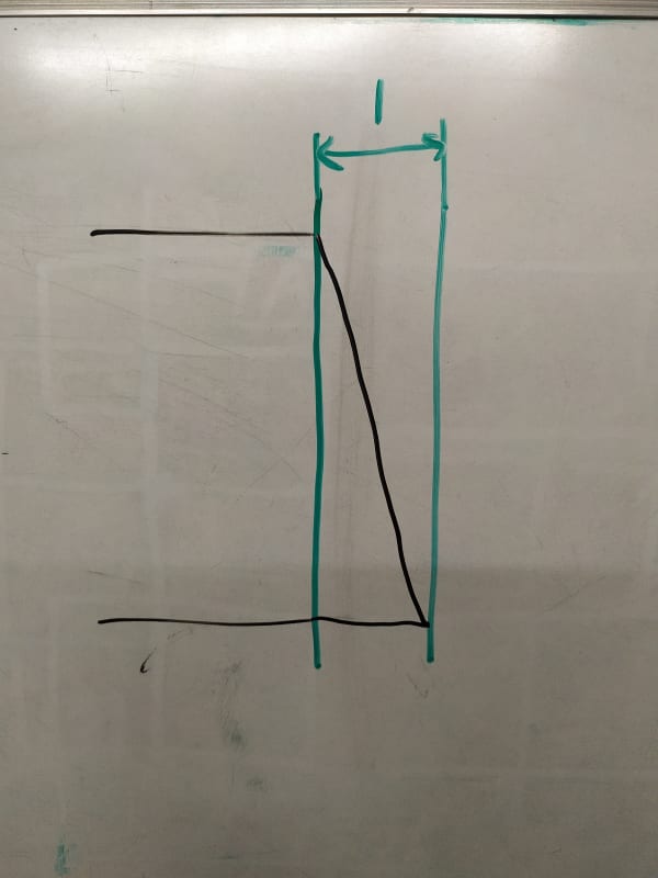

pmarc,
Sorry to put words in your mouth. I believe that you were thinking of the effect on the left, and I was thinking of the effect on the right:
As the slope of the basic surface increases, the line element parallelism zones are not as vertically "tall" as the profile zone. I agree that this would happen.
I was thinking that the 2D parallelism zones would not control the "tilt" of the surface in the perpendicular direction, so that the surface could be tall on one side and short on the other, within the profile tolerance.
burunduk,
I imagine that you are thinking that the surface in the right-hand diagram could have resulted from translation, and would thus be allowed by the composite profile tolerance. This may be true, but I would say that this only occurs because the true profile has special case geometry (arc of a cylinder, with constant curvature). If the surface was not a simple cylindrical arc, but was a more general curve, then I don't think that the rotation could be duplicated by translation.
