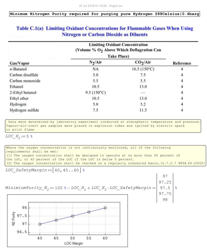

As per NFPA 69 ( ) to purge H2 gas (100% pure) I need to maintain following range of N2 gas purity. Given that NFPA (& I failed to get any other document) doesn't describe dependency of temperature & pressure upon LOC (Limiting Oxidant Concentrations) ...how do I know that the range of N2 purity calculate will be adequate for my process conditions?
Guidance on this topic of LOC at some other P/T may be found on page 26-54 of Perry Chem Engg Handbook, 7th edition. Note that the value of LOC of 5% for H2 matches exactly with the UFL listed of 75% v/v of H2 in air at 1atm, ambient temp.
