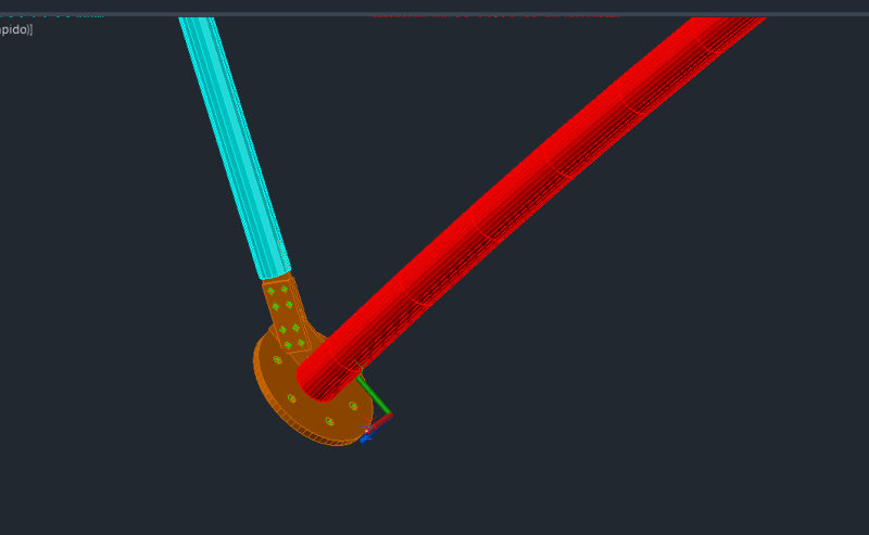

I have another question related to the arched truss.
At the base, the chord and diagonal are meeting. For constructibility, i'm using Gusset Plates as shown in the figure below. Since the CHS has little strength for perpendicular forces at the connection, i thought of using the KISS method. Since the CHS has a small rigidity compared to the plate for these forces, i think that there`s enough ductility that justify using the method but would like to know if someone has a problem with it. I`ve only seen the Kiss method used for W-shape Beams and columns, so am afraid of using at another situation.
Thanks in advance.

I think it would be better to focus on the overall structure, rather than on joint details during preliminary design. For a 50m span, a horizontal truss may be more suitable than an arch shape. It would be better able to resist wind forces as well.
BA
Actually, the structure will be to two arched trusses connected by horizontal trusses creating a box structure, ao these horizontal trusses(2m height) are effective against wind.
Unfortunately i don't have much time for changes on the shapes. I already finished the design of the members, checked for stability, serviceability and ULS and the client is pressuring for the final design.
