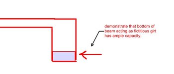

We are working on a reno where a 10kN load is being applied in the weak out of plane direction of a concrete beam. The equipment is intended to be hung from the beam with angles bolted into the concrete. I'm trying to determine whether or not the beam can resist the torsion and resolve it into the monolithic slab, or if I have to add some sort of diagonal angle bracing going up to the structural slab and check the slab for punching. Ideally I can just bolt my bracket on and move on.
Beam is 14"x26" deep, poured monolithic with a 5" slab.

This doesn't sound like a terribly big deal. I'd be inclined to check the bottom of the beam as a fictitious girt. The goal being to demonstrate that the fictitious girt has gobs of capacity for this action such that torsion / interaction stuff doesn't warrant further investigation. If this doesn't pan out, then maybe look at other stuff.

Since I am providing an angle to midheight of beam, how much height of concrete would you use for the "fictitious girt"? I'd imagine the concrete bearing near the bottom ould take most of it for one direction, but the angle on the otherside would be held by tension of the anchors which would bring the resultant higher than the bottom say, 2-3". For this girt, would you just rely on the outermost bar (I have 3 bottom bars) and ignore the central and compression zone (when looking at lateral loads) bar?

Designer's discretion. Maybe treat it as an L-beam using a compression block half the depth of the beam and the outer flexural rebar?
I don't think the connection location or direction really factor into my approach. You'll design the connection as anchorage using unreinforced concrete principles. After that, the load will have no trouble making it's way down to the bottom of the beam.

I don't know what to tell you. The fictitious girt thing is just another way to check torsion. If fictitious girt doesn't work, then torsion might not work.
Even with the slab connection at the top, the bottom of the beam is still going to see lateral deformation as implied by the fictitious girt to some degree.
A 5" slab is not super convincing as torsional restraint for a beam of that size in my mind. And, depending on the detailing, it may only be suitable of loads directed inwards.

Trying the girt method I end up with quite a large moment, so it's looking like I need to brace to underside of slab.
A brace is just another version of rectifying the torsion with slab flexure. So maybe using the slab alone for that purpose is your path after all.

ACI concludes that low-enough torsion doesn’t appreciably impact the flexural capacity or shear capacity of the beam and so can be ignored. That’s like 9 kip-ft (unfactored) for your beam, if f’c is 4,000 psi. Napkin math says it could be close.
