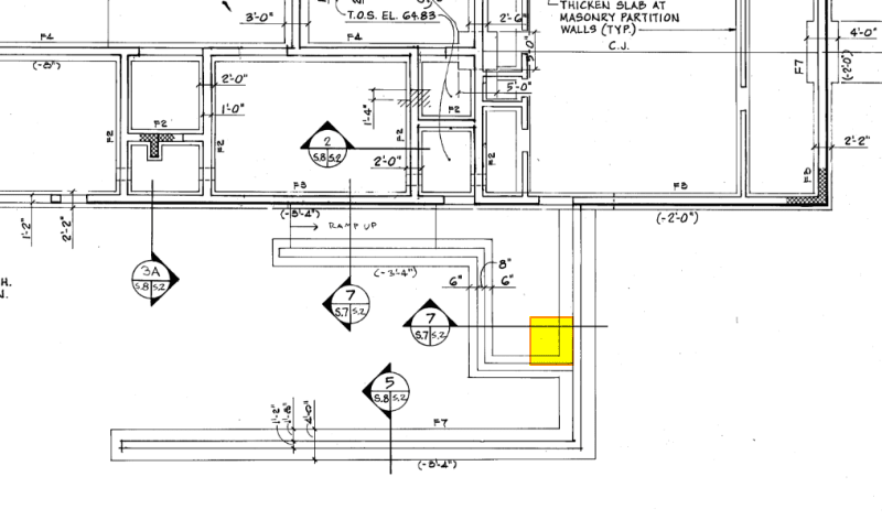

Would you be concerned about frost heave in this loading dock? The client wants to put a walk-in freezer on the loading dock (see highlighted corner of plan below). I raised concerns about frost heave since the one side of this slab is floating.
Their argument is that if the slab did heave, it would all move together, and the freezer would just move with it. I don't think this is the case. I think it is possible that the slab could crack and heave below the freezer, which would open up the joints between the insulation panels and render the freezer unusable. The proposed freezer is 4ft x 5ft.

I am not concerned that the freezer will cause frost heave. I am concerned that the slab could heave and damage the freezer.

Ben29, I would consider two things: Is the soil under the new footing and under the new slab conducive to frost heave and what does the local building code require for frost protection depth of footings?
While the joint against the existing building wall is a place where water could infiltrate into below the surface it is unlikely a wall there cast with the slab would be better since water could still infiltrate the seam between the walls and push on both walls. Proper sealing between the joint is key. Is the loading dock sloping away from the building? The distance between the wall and the freezer is sufficient that a saw cut joint would prevent frost heaving the entire slab. But after how many years has it heaved yet? Design a steel skid for the freezer to sit on with leveling legs to ensure the structure can move as a unit without stressing the freezer.
