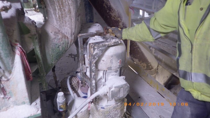

Trying to determine if a lifting jig used to lift a motor can support the load. The jig has a gusset plate welded on both sides. Struggling to find the resistance of the weld at B and if the weld and gusset can support the stress at C.

Why are you using a 5:1 SF for the appliance?
5:1 is for the wire rope of the crane that is continually being wrapped around the drum and sheaves and then straightened back out again - something almost fatigue-like. This appliance is not experiencing that, is it? Will this be a dynamic lift (static crane lifting from a heaving barge deck) or a suddenly-applied lift? If not, then a 5:1 SF for this part might be reconsidered.
Engineering is not the science behind building. It is the science behind not building.
To E.T.:The factor of safety 5:1 is to take care of the stress concentration where the hole was made for the lifting eye bolt.
I personally would use a channel instead of a flat plate in order to minimize deflection which has not been analyzed from the info. provided; also I would strengthen the hole with a double plate or weld two rib plate connecting the two side of the channel around the hole.
Use all square or rectangular tubes and flat plates next time.
There will be a bit more welding
This will give you a frame that is less "bouncy"
MJCronin
Sr. Process Engineer
400 lb? You can safely lift that with stuff from the hardware store...
