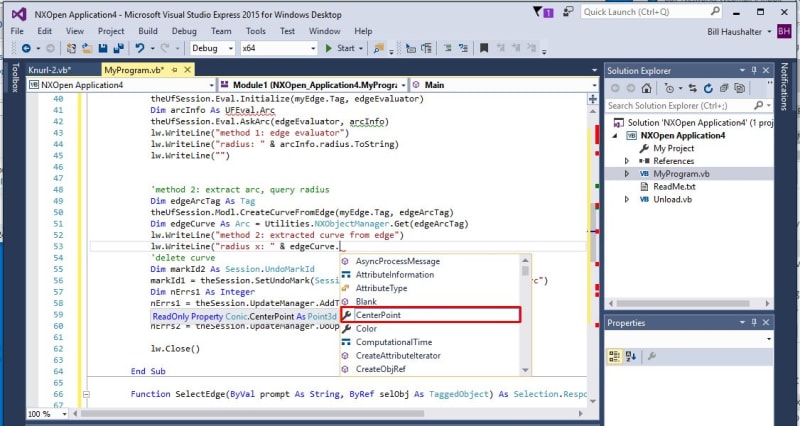

One very helpful learning tool for me was to install the free version of Visual Studio Express with NX Templates. I still pirate most of my code from the web but when I'm modifying it in the Editor it will give you allowable suggestions as your typing.
Currently I try to use Notepad++. Would you suggest switching over to Visual Studio Express?
