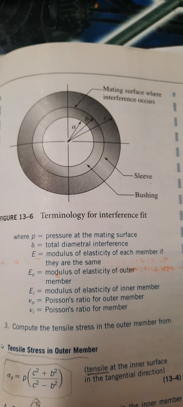

I am trying to find a formula that will determine pressure at the mating surface where the housing/spring eye is open and not welded shut into a bore. Both materials are steel. I would think it would have to incorporate perhaps a spring constant or the something similar? I could not find anything in any of the design books I own.

The formula shown would be useless as soon as one would make a cut in the outer housing as it would no longer be attached (like a leaf spring eye is). I want to calculate the mating surface pressure which I can then use to determine the stess in the outer member.
