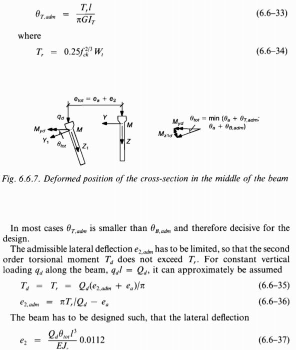

I had a look at the clause you mentioned. I have a few doubts. Hope that someone can give me a lecture [upsidedown][bigears].
- FIB clause recommends torsional stiffness GJ to correspond to the depth of the compression zone under the first-order moment but for Tr(torsional cracking moment), I will be using the whole section (full depth) resistance as flexural cracking does not affect Tr. Is it ok?
- In equation (6.6-35) why do I need to divide Qd(e2,adm+e) by π (Pi)?
- Although I am quite curious about how they derive this e2 (second-order deflection), I guess it will be lengthy and I will just use it as it is.
- For your easy reference, I have included a screenshot of the fib clause formulae below.
