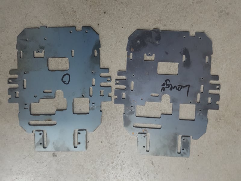

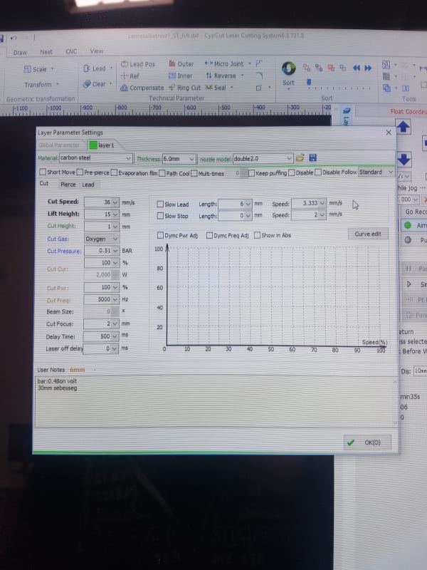

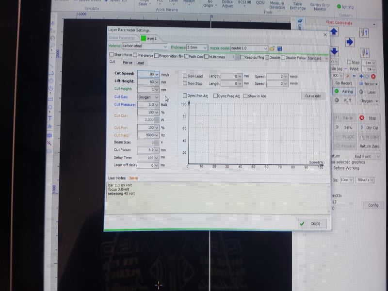

My question is that I have a 2kw fiber laser machine and would like to cut lv1.5 material either with oxygen(Left picture) or air(Right Picture) (12bar compressor) but the oxygen is different in size and the cut is almost good in air but the cut is not perfect. The bottom of the material remains a bit cluttered and I don't like it. Is there anyone who can find a solution? Attaching pictures. Thank you in advance for your help!
Cutting with air always requires quite a high gas pressure and much more power than with Oxygen.
Sometimes a focus adjustment can help also.
In truth, I think everything affects everything else, probably you need a wide enough kerf to get a high enough gas velocity through the cut to blow the molten steel clear of the edge of the cut.
A wider kerf requires more power, and probably a bigger spot size.
Spot size is function of lens focal length, properties of the raw beam, and position of the focus waist w/respect to the material.
Generally, you find a way to conduct cutting tests quickly and zero in on the combination of parameters needed with your machine and your material.
Usually those tests don't require an entire part, just test a few representative features on some scrap material. Then you use that info to tailor your part's cutting parameters.
