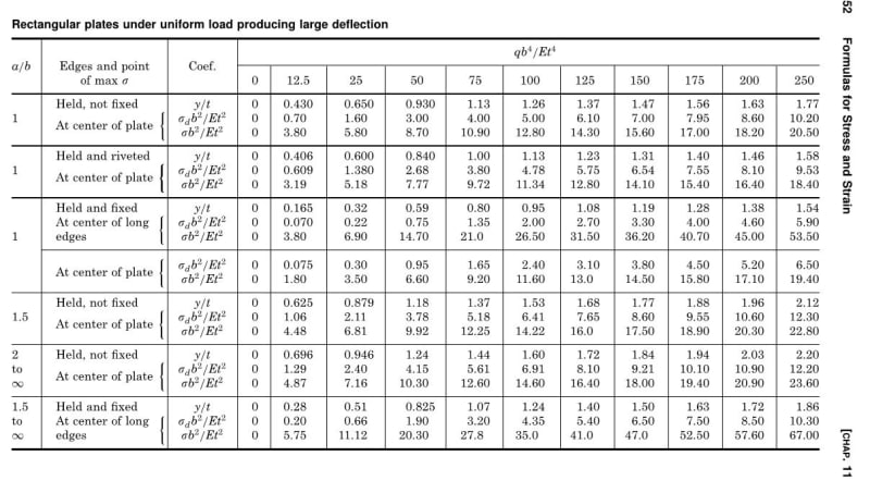

I would like to produce some deflection vs uniform pressure diagrams for a 3mm thick aluminum panel product. I mistakenly thought that this would be easy and it's turned out to be rather difficult. I'm hoping that someone can either a) point me to a suitable method or b) confirm that no such method exists. Some thoughts/background:
- Per the graph below, non-linear membrane actions factor in significantly. I've erroneously used Timoshenko's small deflection equation to produce what is effectively my own version of the straight line. When I got to looking at the deflections, I realized that they greatly exceed the member thickness.
- Resource wise, I've got Timoshenko's plates and shells, Roarks, and most of the old papers cited in Roarks.
- While I don't need this to be super easy/simple, I don't want to get into FEM or Finite Difference with this. I also don't want to be assuming shape functions and doing virtual work in the form of variational calculus. This kind of thing is mentioned in the papers cited in Roarks. I'm sure that it's great stuff but I'm afraid that my math skills are not of a caliber that I'd trust myself to attempt this kind of a solution and pass it off to my client as results in which I was confident.
- Even if I can find a reasonable method to account for the membrane action, I suspect that most such solutions would assume the pinned supports to provide perfect in plane restraint to the panel edges. I doubt the truthiness of that in most applications. And assessing the surrounding structure for its contribution to membrane deformation would increase the scope of this assignment substantially. I know that, in many cases, panels can sort of create their own compression ring from which the membrane can be suspended. No doubt that's what happens with metal panel but, again, accounting for it simply seems to be a pretty tall order.
- I stumbled upon this document by Enclos. They actually propose a formula for this scenario but the equation got all jumbled on the greek variables. Anybody know what this equation is supposed to be?
Do the large-deflection tables in Roark help? Page 407 and 408 in the 5th Edition.
Do you mean the table below from the 7th ed? It's a step in the right direction but I'm hoping to hit a few more aspect rations. Also, poisson is 0.312 whereas I need 0.33. Small difference probably. And I may be able to figure out how to adjust for that. I guess part of my hang up is that the table may not spreadsheet all that easily. Color me lazy.

Kootk, you could have a look here: it's a rectangular plate with supported but unheld sides, a case that's not treated by that table in Roark. The solution is obtained by minimization of the strain energy, not exactly what you say to be prepared to face; I don't think, however, that a single formula could cover all different condtions (aspect ratii, held-unheld, etc.). You could calculate yourself a number of cases and build a table or an interpolation formula.
What you mention, a panel that has supported or unsupported sides, where the sides are stiffened, is not treated at xcalcs nor elsewhere: it could however be solved with the energy method.

I've been watching this post for the past few days to see what suggestions others have provided. I don't know how many other engineers have been involved with static and dynamic wind pressure testing on 3mm aluminum plate or 4mm aluminum composite material, but I've designed and conducted quite a few of these tests. Here are some of my observations from the actual pressure tests:
1. In general terms, the plates do not deflect as much as calculated when using Roarks deflection coefficients based off of the plates boundary conditions. KootK, like you mentioned in a previous post I think most of this can be addressed through membrane action.
2. After the plates have been loaded in both the static and dynamic pressure tests I have seen quite a few plates that didn't meet the permanent set deflection criteria for these tests. Based off of this information it leads me to believe that the plates were stressed beyond the elastic deformation range. When you compare the Roarks stress values for these scenarios, Roarks would indicate that the plates would should not become overstressed and should recover to their original state. Again, this makes sense with regards to membrane action.
Based off of this information I do feel that large deflection formulas would be more appropriate to model the plates actual behavior. However there aren't many clean and easy formulas that engineers can quickly utilize, especially when analyzing non-structural cladding elements.
All that being said, I've seen quite a few of the leading US consulting engineering firms and manufacturers use the Roarks formulas to quickly analyze the plates and their performance. I'm not saying this is the best solution, but I wanted to paint the picture of real world results versus what the majority of others in this industry are currently doing.
We use alot of 3/16 alum (4.7mm). I do recall that (in general) the calculated deflections are more then that measured for these plates. They are tested by walking on them or using 300lbs wieghts and measuring deflection as they are used in walkways. So they 'normally' do not like to stress the products beyound their apparent yield points, cause if I bend them they do not sell it. In these cases actual stress and safety factor is measured by the deflection. It is disconcerting to read that the calculated stress is non conservative and the opposite of the calculated deflections which are conservative.
I have bent enoough products of the thicker materials to confirm that calcs are closer to actual measurements with thicker materials.
