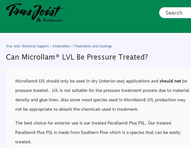

1) Interestingly DC6 for decks prohibits this kind of connection. I've always wondered if that prohibition only applied to non-engineered solutions though. Certainly, I've seen plenty of examples of similar connection in other engineer's drawing in the past.
2) If the numbers work on the bolts, I'd think this would be ok. Shrinkage ought not be a problem for engineered lumber. Is this pressure treated PSL? If it's LVL, it's probably not treated which might present a problem in an outdoor application.
3) Assuming that's a 6x6 post, your load eccentricity on the column would be about 4.5". It's probably alright for smaller loads but, at the same time, it's easy to check and I'd be inclined to check it.

The LVL might not shrink, but the post will. Looks like it already has a big split.

I'm with KootK, LVL's are not good when exposed to moisture. Long term, that could be a bigger issue than the connection to the post.
I'd say this is no good. I think everyone's touched on my reasons, but to reiterate:
1) As KootK pointed out, LVLs should NOT be used outside. I like to think of them as really thick plywood - have you ever seen plywood after it gets wet a few times? Even exterior rated adhesives is susceptible to long term wetting (or even short term along the edges where the moisture can work in between the plies).
