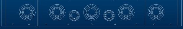

When unfolding or folding a part, I run into the problem that the knockouts don't follow...
Right now, I made the knockout on the flat pattern and it looks like that :
Which is perfectly fine.
But then, when I tried to fold back the part, it does that :
Is there any way for the knockout to follow the fold?

Something must be odd in the way its modeled. I would make the knockouts as a form feature.
It actually is a form feature.
I found the problem, it was in our config.pro file.
The command smt_merge_form_sides yes was removed for an obscure reason...
Adding it back solved this issue.
