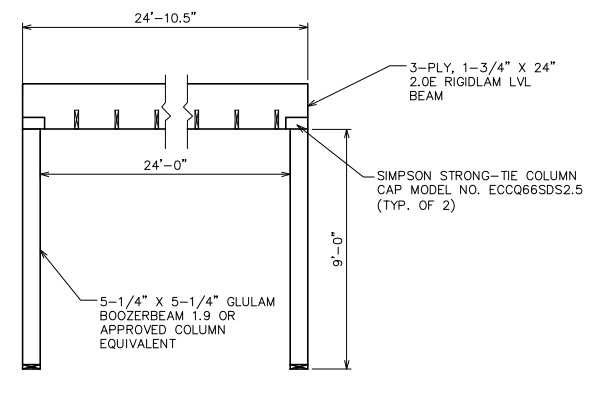

I have a residential site where a 3-ply LVL beam is spanning a new 24' opening and sitting on a 5-1/4" square structural glulam column on each end and attached with a Simpson column cap.
Are there any code requirements for # of king studs in this scenario since it doesn't fall into the usual jack/king setup layout from the IRC? Top plate does not continue above LVL and will stop at the kings.
Here are some of the details, let me know if that isn't what you are looking for
Agreed with KootK. All you should need is a single king stud in a situation like that.
Sounds great, thanks for the feedback!
