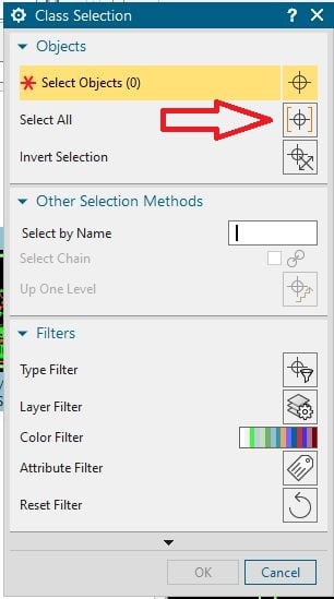

after you set that filter to what you have press OK then on the menu there is a SELECT ALL button then press OK again.

Hi Jerry,
I forgot to mention this step, actually I use select all, but there's a way to select on all pages of a drawing at same time?
Using as I mentioned I need to enter in each page to select all.
Thanks!
I do not think there is a way to select all pages of the drawing at the same time, but I could be wrong.
