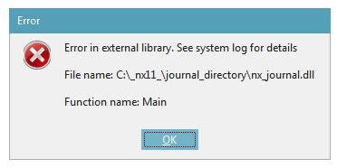

Hi
Do someone can explain/guess what this error mean
the journal compiled without errors.
But run with the following error.
any help
Thank you in advanced.
Hi Ehaviv,
Have a look at the syslog. I encountered this message on station with framework 4.5 instead of 4.6 which it's necessary for NX12.
Regards
Didier Psaltopoulos

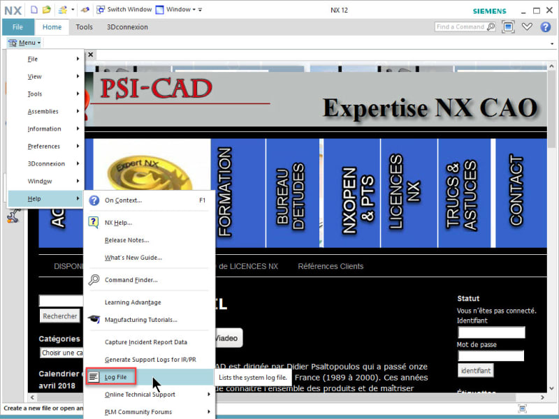

Hi Didier and thank you a lot.
Where I look for this syslog.
Do this is belongs to windows or nx. ?
Then check the bold lines after the error message
&MACRO MESSAGE_BOX -2 Error in external library. See system log for details

&MACRO MENU, 0, UG_HELP_SYSTEM_LOG UG_GATEWAY_MAIN_MENUBAR <RibbonTopBar->MenuBar->UG_HELP> ## !
Successfully loaded dynamic module C:\Softs\UGNX12\nxbin\libhelpint.dll
Loaded module c:\softs\ugnx12\nxbin\libassyrni.dll 7fec2bd0000 14000 f7dc4c13-416f13da-cb7e89ab-fc6f321d-1=libassyrni___1517028019cyp version = 12.0.1.7
