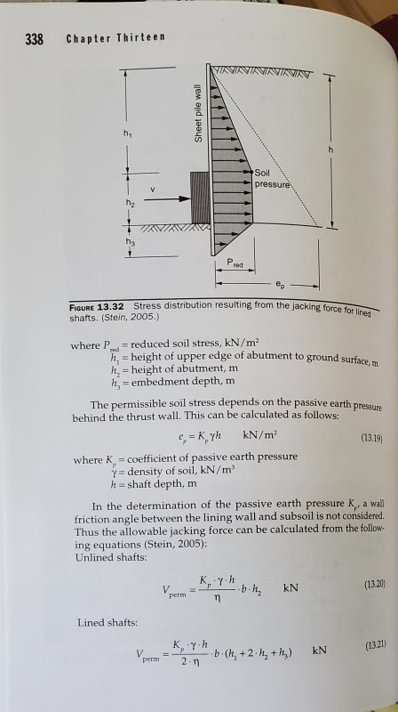

babibibak, as you requested, here are some hand sketches of pressure distributions that I used on the Ivy League project for the theoretical, triangular, passive pressure behind the block and for the trapezoidal passive resistance distribution that I invented(?) and believe is more representative of the situation than is the triangular distribution. But, remember, I checked both distributions.

OG, I can't say for sure, but I don't think T&P ever used a trapezoidal distribution for passive pressure and I don't think that you will find the method I used in any soils or foundations text books. Yes, my trapezoidal distribution is a reaction or resistance, not an active or at-rest driving force. It assumes that the SSP is being pushed against the soil behind the SSP. I did not design a "SSP wall" to resist the jack load. I designed a very large "heel block" or "deadman."

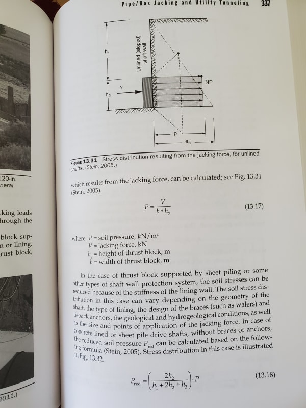

The trapezoidal pressure is actually presented in the book called "Trecnhless Technology" by Mohammad Najafi. I am going to determine the embedment by the equation and check the sheet pile for flexural. PEinc this is consistent with what you have done. Well done!
Nice. I never saw that book. It's great to know there actually is a reference. Thank you.
It looks like the book is not using wall friction. That will have a big effect on your design.
EDIT: Just bought a used copy of the book on Amazon. I hope I get my $40's worth.
