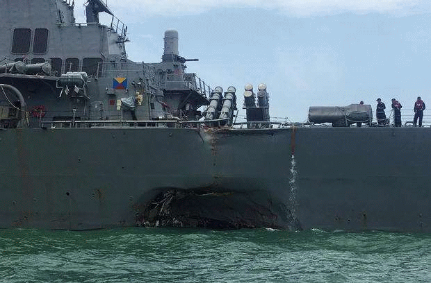

It's happened again...
U.S. Warship Collides With Merchant Vessel East Of Singapore
This is the second accident involving U.S. Navy destroyers in Asian waters in little more than two months.

Just great, their radar has a gigantic blind spot for merchant ships. Kind of like Tesla's blind spot for the sides of semi trailers.

This one appears to have been hit much more broadsided than the previous one

I can't see how anyone was even looking out the windows to have this occur,
nor was anyone looking at any radar. The McCain is a measly 500 feet long with
a 100,000 shaft horsepower and can exceed 30 knots, it's a nimble ship! It
should be proactively staying 1000 feet from any other shipping.
I'm starting to think they should be putting bridge video loggers in these one
point eight billion dollar machines.

Considering that the destroyer is not broadcasting its position and is designed to have as small of a radar signature as possible, is it reasonable to even consider faulting the commercial vessel?
I'd start to be more concerned that a foreign adversary has managed to hack into our ships' control/navigation systems and is somehow disabling or otherwise causing them to malfunction at inopportune times.
Not withstanding Spartan5s remarks , the commercial vessel is still at fault under Colreg rule 15, first she was the give way vessel secondly she was in violation of rule 6 " Every vessel shall at all times proceed at a safe speed so that she can take proper and effective action to avoid a collision and be stopped within a distance appropriate to the prevailing circumstances and conditions. Of course that does not let the McCain completely off the hook either , she runs afoul of rule 17 " Rule 17 has three stages and you must identify and assess each of them: Rule 17(a)(i): when you are the ‘stand-on vessel’, you must keep your course and speed. You must not do anything unexpected. Rule 17(a)(ii): ‘as soon as it becomes apparent’ that the give-way vessel is not taking appropriate action, then you may take your own action to avoid a collision. Rule 17(b): when a collision cannot be avoided by the give-way vessel alone, then you must take the best action you can to avoid colliding. Your action under Rule 17(b) must still be in time to avoid a collision so you must not leave it too late. "
