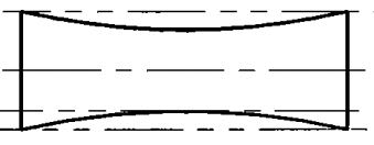

Yes, I am saying that GN alone is not enough. As you said, this is global-size type of requirement therefore it doesn't control all necessary aspects of the size of the feature. Imagine this kind of shape:
Size callout with GN modifier will only control how big/small the envelope circumscribed about that external feature can be, but it will not have a power over controlling the depth of the saddle. As I showed in my previous illustration, to fix the problem a combination of GN and LP modifiers would have to be used (if you really wanted to use GN modifier) or just circle E modifier.

greenimi, chez311,
Yes, this has a lot to do with actual local size definition in Y14.5.
Limits of size definition given in para. 2.3.1 in Y14.5.1M-1994, which is based on swept-spheres concept, indeed doesn't allow the circular elements to go beyond the circular boundary of MMC size (also beyond the circular boundary of LMC size), and that's a deciding argument that those who think that a DML straightness at MMC may affect allowable circularity of the cylindrical feature are incorrect.
But this also means that addition of a DML straightness at MMC requirement to a combination size and position at MMC callout on an ASME-based drawing, as suggested by chez311, doesn't produce the same set of requirements as a combination of size (with default lack of envelope requirement) and position at MMC in ISO. It's because in ISO default interpretation of a linear size callout is two-point local size only, therefore there is no reason why a cylinder with all actual two-point sizes equal to MMC couldn't still have a certain amount of circularity/roundness error, like a tri-lobe shape.
Another problem with the swept-spheres based Y14.5.1M-1994's definition of limits of size (not mentioned in this discussion yet) is that when the Independency modifier (I) is added to the size callout of a cylindrical feature of size, the limits of size definition causes that the (I) modifier isn't able to release all aspects of form error, as it should, in my opinion. In other words, while straightness error gets indeed released by the application of (I) modifier, the circularity error must still not be larger than the size tolerance, which is kind of against what independency of size and form means to me (and to ISO). Just a thought.
I'm not sure if we need the independency modifier in ASME to achieve a functionally equivalent result. If we take your initial example:

What if all actual local two point sizes of the pin were LMC = 59.6 and the actual pin was a tri-lobe? That would be fine according to ISO, but it would fail the swept-spheres based ASME definition, wouldn't it?
So yes, I agree we don't need the independency modifier in ASME to achieve equivalent result. We need the independency modifier AND something that would override the requirement for containment of the surface of the feature between two half-spheres of MMC and LMC diameter and impose pure two-point size instead.
Agreed. Towards MMC (diameter of local size spheres per ASME from 60.0 to 60.3) the ASME scheme accepts functional parts and the ISO scheme rejects functional parts. Towards LMC (actually past LMC per ASME - diameter of local size spheres per ASME from 59.6 to 58.9 with 2 point measurements of the cross section no less than 59.6) the ASME scheme rejects functional parts while ISO accepts them.
Acceptance of these previously rejected functional parts could be allowed if the ISO scheme was changed to read the same as the ASME one ie: 60.03 +0/-0.7 and 0 position tolerance @ MMR but without the envelope requirement. Now the ISO scheme would be more lenient across the board.
