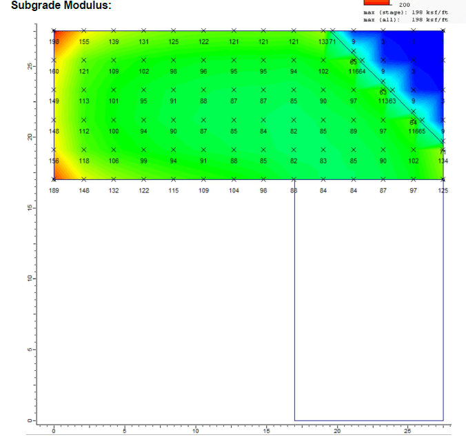

Echoing others here, I use it for mat foundation design, and no, we haven't caught up to somehow using bearing pressure to define soil stiffness (except for the famous formula, I think by Bowles). I'm wondering, if it's so flawed, is there a better alternative? I'd use something better in a heartbeat.
The most accurate way to determine modulus of subgrade reaction is to do a settlement calculation using FEM, then you can have contours of K and how it changes with displacement beneath the raft. We do this and then export it to the structural engineers who import it to their structural software. It is a bit of an iterative process.

Yes, you need loading and also footing dimensions. I suppose in a pinch you could use various loads and give a range. I think the idea is that the geotech gives the structural a bearing capacity. Using that and the column loads, the structural sizes the mat foundation and passes it back to the geotech. The geotech uses that loading and size to get the subgrade modulus throughout the matt foundation and gives it to the structural (I provided a contour map). Then the structural can use that in their own FEM to see how the mat foundation will bend and how to reinforce it. If resizing is necessary then the it goes back to the geotech and so on. That's the iterative process that EireChch was talking about.

I'm not entirely sure about the FEM concept. Hooke's law states that F=Kx. So you get the F from the engineer (or assume something), get the settlement based on geotechnical equations and soil layers, and then you can calculate K. Why would you need FEM for that? It seems like an equation you apply over a 2D space.
Getting the settlement under a mat is what the FEM is for. It can vary a lot from center to edge. Here's an example:

My understanding is the subgrade modulus, determined from the 1 ft plate test, isn't really appropriate for use in Mat foundation design. The formulas proposed in most Geotechnical texts to modify the 1 ft plate test for actual foundation dimensions trends to unrealistically low values when modified for full building mat foundations. A common practice that I have seen is to use the 1ft plate test result without modification and then run the model again with double and then half the value and look for any variation.
