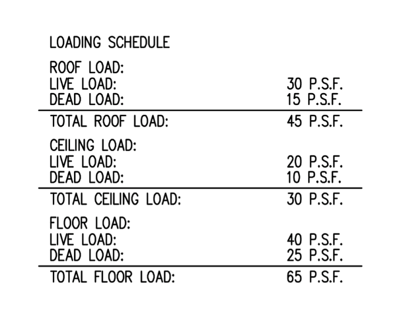

FWIW this is what I've got from the plans...in New Jersey
This should go back to the engineer who was hired for the project, but then again, others may have been involved. Specifically, is the roof trussed, and are the trusses deferred submittals? If so, the engineer may not be able to easily analyze the roof truss system, and short of re-evaluating the existing dead load, this may also need to go back to the truss supplier to ensure the nail plates and chords are sufficient for additional loading. These situations are usually much cheaper to address during design, rather than after construction.
The IEBC (International Existing Building Code) says reroofing material 3 psf or less is acceptable for Alterations of existing buildings (generally without need for analysis). Your 6 psf is double that allowable. You should have it checked by your engineer.

Deduct it from your roof live load, and limit remaining occupancy accordingly.
If it were purely a roof and designed to code, it probably wouldn't be a major problem, since the typical soaking wet roofing tile is on the order of about 6 lb/sf and usually has plywood underlayment. The only thing I typically see is some diaphragmic sagging on house roofs, which is why I personally got a metal roof.
However, you imply your roof was designed for entertainment, or at least, lots of people walking on it, but the loading schedule didn't allow for the same loading as your floor load, which seems problematic to me, since the membrane structure eats into some of the dead load, but you likely have a little headroom, assuming your membrane structure is less than 3 lb/sf

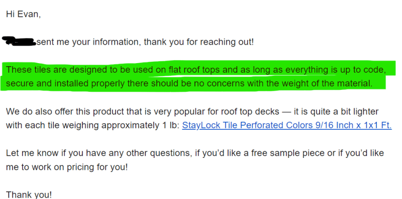

lol sales person doesn't think it is such a big deal lol [wink]
The builder was actually asking us if we wanted "tiles" installed on the roof, but he was Russian and English wasn't his first language so there would be miscommunications. We thought he was talking about ceramic tiles and grout, had no idea how that would work.. He may very well have been talking about these type tiles lol.

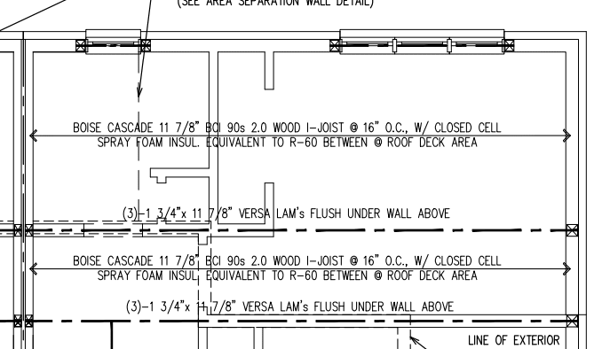

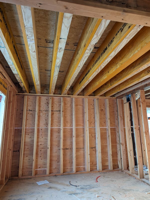

This is what I've got in the ceiling of the 2nd floor under the roof deck:
Here's some roof deck porn framed to support a hot tub lol: (The other deck does not have all of the additional LVLs)
