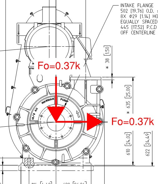

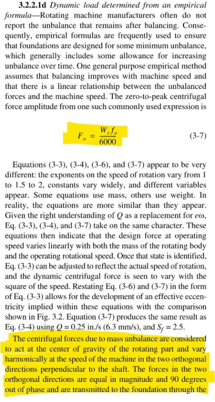

Joel, I'm currently going through the ACI 351.3R-11 that you provided (thanks again for that) and have a couple questions that maybe you could help with. Under section 3.2.2.1 Dynamic loads due to unbalanced masses--they provide a few different options to calculate these loads. I've decided to use eq. 3-7 (Sect. 3.2.2.1d Dynamic load determined from an empirical formula). See Fig. 1 below. Using Wr=5500 lb (weight of pump, probably conservative) and fo = 402 rpm; I'm getting Fo = 370 lb...which seems small. Maybe I'm just used to large structural loads in kips.
Q1: Does Fo=370 lb seem reasonable?
Q2: Am I understanding correctly that Fo acts as I have shown on Fig. 2 below?
Fig. 1
Fo = dynamic force amplitude [lbf]
Wr = rotating weight [lbf]
fo = operating speed [rpm]
Fig. 2
