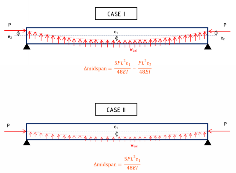

What rapt refers can be easily understood for a simplistic case of a simply supported beam with end eccentricities ABOVE the CGS. Such end eccentricities makes the midspan deflection worse (less uplift), as per the attached two cases, where I just rearranged 5wL4/384EI and P(e1+e2)L2/8EI for midspan displacements, under the actions due to prestress due to wbal and end-eccentricity of prestress, respectively.
The PL2e2/48EI term is making the midspan uplift LESS compared to CASE II with the same prestress, less "sag", yet with no end eccentricity.

In Case 1, the drape is e1 + e2, not e1, so the balanced load deflection is 5PL^2(e1 + e2)/48EI.
After subtracting off the end moment effect, Case 1 result is 5PL^2(e1)/48EI, exactly the same as Casse 11.

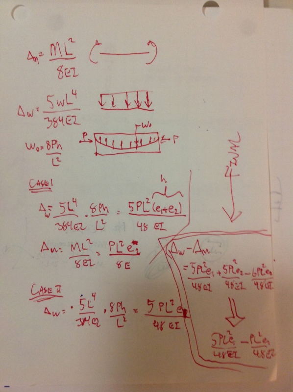

I was curious too so I did a little fact checking myself last night ('tis the season). Turns out Inginuity is fit to lead the free world after all. Or at lest design a little PT.
Excuse the quality. I wan't originally intended for public consumption.

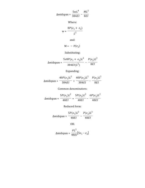

rapt - just some mathematical 'gymnastics' to get the reduced form. See below.

If you've already got it prepped then... yeah. I think that midspan moments do come out a tie.
Sorry Ingenuity, I had always assumed it exactly cancelled the increased uplift effect and commented before looking into the derivation. But looking into the math you are correct, it actually makes your deflection slightly worse, contrary to some designers expectations.
Which would explain why lowering the tendon at the anchorage below the centroid in a simply supported span (and the reverse in a cantilever), reducing the "drape uplift" but introducing a beneficial set of end moments, actually helps reduce deflections.
This is one of the reasons I have always tried to talk designers out of thinking in terms of load balancing. They tend to think of the drape effect only and not the "secondary profiling effects" (as distinct from Secondary Prestress (parasitic moment)) like moments from end eccentricities. "Moment Balancing" is a much safer concept!

Yes, with a determinate member, the mid span moment is P * e1 no matter what!

Yep, even if you consider a prestressed plank (and ignore strand end-slip etc) with straight strand of constant eccentricity, e1, [CASE III below] there is 20% more midspan uplift than a parabolic drape of e1 'sag' with the same prestress [CASE II]:

No, I didn't do a FE analysis. But I concur with rapt with a midspan moment of P*e1.
