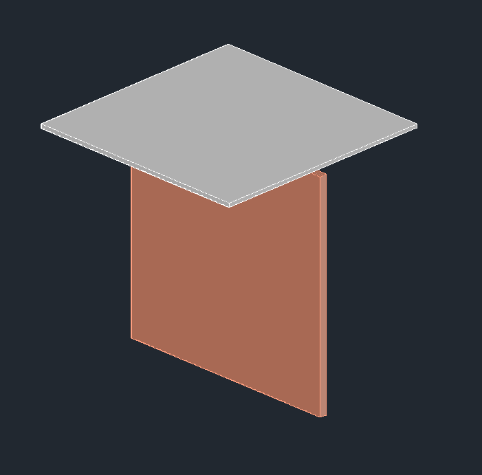

I've been trying to find out if there's a requirement to restrain internal brick walls which act as a shear wall.
This would be at the top, to the roof or roof truss members.
This would be a common scenario to any dwelling with internal brick walls.
At the moment I have a gap in between ceiling and top of wall (see image).

A single wythe brick wall is a veneer, not normally considered to be structural. If the wall is built up with more than one wythe and adequate as a cantilever to resist lateral pressure (5 psf by code), it could be unsupported at top. It is not clear how such a wall could receive much shear load if not connected at the top.

Thanks for responding. Just to clarify the shear load is along the length as shown.
These do act to restrain against wind loads.
The query relates to whether lateral restraints are required at the top.
I understood the question. The wall could serve as a shear wall without being connected at the top provided it could stand as a cantilever. Alternatively, it could serve as a shear wall if laterally supported by other walls or partitions at an acceptable spacing. A brick wall which cannot stand as a cantilever and has no other lateral support should not be used at all, let alone as a shear wall.

I agree with BAretired here; the wall is either a cantilever wall with some kind of clips to transfer the lateral load from the diaphragm or the wall should be braced for seismic forces and out of plane live loading to act as a pin-pin wall, in which case you would still need to address shear transfer.

Wait so, don't all shear walls have to be attached to the diaphragm along its length for them to be considered shear walls? How else would diaphragm forces get into the shear wall? Unless there are other collector members to transfer the shear into either end of the wall.
Without restrain on top, the walls forming a free standing T beam system. Stability of the stem is in question.

From the way you've described it I do not agree that this wall is acting as a shear wall. It sounds like an interior partition that's unbraced out of plane and if its a single wythe it's not designed as a cantilever.
I'd recommend you seek out a local structural engineer.

I'm not saying you're saying this, but just to be clear, the detail you have showing with the "cornices" could possibly be enough to brace the top of this partition wall. And I can also see how ceiling plasterboards can act as part of a diaphragm. But still in no way will the wall in that detail act as a shear wall.
Doesn't matter if ceiling plasterboards carry lateral load or not, there is no way for them to transfer into your wall. Bracing a top of a wall because it won't be stable to out of plane indoor loads (5 psf) is entirely a different issue than using the wall as a shear wall for lateral analysis purposes. If you are going to depend on this wall as a shear wall then you'll need a positive attachment to the wall in the horizontal direction while allowing for vertical deflection.

Just think, typical dwelling, two leaf/wythe external wall, single leaf internal walls which take the wind shear load. What is enough lateral restraint.
The detail above is used, we know that.
(1) It's used even considering the out of plane loads mentioned.
(2) What I don't know for sure is ... if the walls carrying wind load, are able to used the detail in the Figure above, where the cornice offers lateral restraint.
