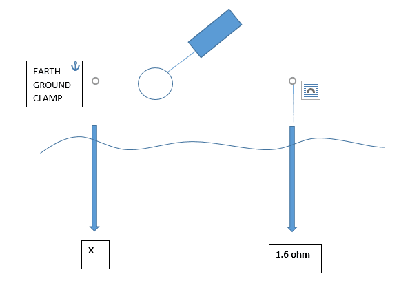

this test is for mesuring earth resistance of the rod for a telecomonication building (data center)
i used earth ground clamp CA6416
the mesure has been made according to stakeless test method
using one existant earth rod by disconecting it from the earth loop and then connet it with this instrument earth rod
the CA6416 displayed 6.2 ohm which is the sum of the resistance of the two earth rods ;we've already known the resistance of the existant earth rod which is 1.6 ohm
so the resistance of the earth rod being mesured is 4.6

C.1. Your existing single rod reads 1.6 ohm. When connected (in parallel) to the second rod reads 6.2 ohm by stakeless method. It seems to be not? right. When the existing is 1.6 ohm , with the new one in parallel, the resistance shell be max equal to 1.6 ohm or lower; but NOT >1.6 ohm!. You read 6.2 ohm, which seems to be NOT right.
C.2. It is NOT right to assumed that the new electrode resistance to be 6.2-1.6 = 4.2 ohm.
C.3. The intension of the stakeless measurement is to measure the paralleled resistance. It shall NOT > 1.6 ohm.
C. 4. Connect two electrodes in parallel and carry out a "drop of potential" method to verify the reading.
C. 5. For telecommunication installations, the recommended earthling resistance is NOT exceeding five (5) ohm.
Note: your existing single electrode 1.6 ohm is good enough. Addition of another is superfluous.

Read my post, Mr. Che.
The test circuit is as follows:
Test instrument to ground loop.
Ground loop to earth.
Earth to electrode under test.
Electrode under test to test instrument.
The connection is a series connection.
The conductor to the electrode under test may be broken and an Ohmmeter inserted or a ground loop tester may be used without breaking the conductor.
Stakeless Ground Loop Tester.

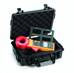

Stakeless earth ground loop testing
June 12th, 2017, Published in Articles: Vector
Testing the grounding components of equipment in hard-to-reach spaces is challenging. Fluke, represented locally by Comtest, now has the Fluke 1630-2 FC stakeless earth ground clamp, a heavy-duty clamp jaw that stays in alignment and in calibration even in industrial environments. Staying online to identify ground loop resistance without the need to disconnect, then reconnect the earth electrode from the system, is now possible. This clamp measures earth ground loop resistances for multi-grounded systems using the dual-clamp jaw. This test technique eliminates disconnection of parallel grounds, as well as finding suitable locations for auxiliary test stakes. The 1630-2 FC supports the Fluke Connect wireless system, which connects the clamp wirelessly with an app on a smartphone or tablet.
Link
A stakeless test requires at least two ground electrodes and measures the sum of the two resistances to ground.
Preferably there is a ground grid or array of ground electrodes.
The stakeless test always returns the sum of the resistances of the electrode under test and the ground grid or array.
The resistance of the electrode under test will always be less than the total resistance indicated by the test meter.

hello again mr Che Kuan Yau
just a simple question if i use the earth ground clamp between tow rods
as showing on the picture
the resistances are in series : resistance of the 1st rod and the 2sd rod plus the resistance of the wire and the earth which are typically very low
and the tester will display the sum of the two rods resistance isn't it

E. " ....the resistances are in series : resistance of the 1st rod and the 2sd rod plus the resistance of the wire and the earth which are typically very low and the tester will display the sum of the two rods resistance isn't it ..."
C. YES , the Sum of two rods in SERIES when the two rods are connected in [parallel !]. Isn't it confusing?.

Mr. Che
Would you care to explain how to measure ground resistance without the effect of the reference ground acting in series?

W. " Mr. Che....Would you care to explain how to measure ground resistance without the effect of the reference ground acting in series?.."
C1. My apology if I failed to understand/misinterpreted or did not answer your question.
C2. I am of the opinion that with A electrode of say X ohm and the electrode B of Y ohm planted some distance far away from A; when connected in parallel; the paralleled resistance shall be equal to/LOWER than X ohm. But NEVER higher than X ohm..
C2.1. The stakelesss method reads the paralleled resistance to be (X+Y ) ohm!. This is unacceptable.
C3. With stakeless method measurement it can NOT " ...measure ground resistance without the effect of the reference ground acting in series?..".
C3.1 For this reason I am considering to raise the " alarm " to the attention of the engineering world to be aware or to BAN is misleading practice/method.
