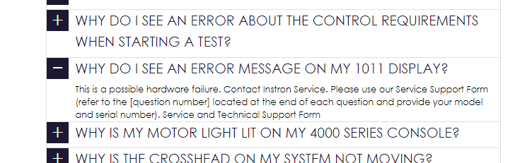

This instron 1011 emitted a mechanical noise and now is stuck with this error:
shall I take apart to see and try to fix the mechanical part or could it be a board?

its no longer covered by the service, they are just offering a new one, don’t even bother to come see it
yes, it just says contact assistance...

I have both the user and the service manual. just say to press a couple of keys combinations, just to reset. I opened the front door and hit a reset button. Same thing
With nothing to explain what inputs are part of the failed self-test and how they are tested and processed by the black box to declare pass or fail you are reduced to guessing.
