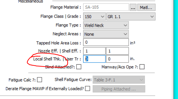

Hi I would like to seek your help. I am doing a design for caustic scrubber vessel. Before the vessel is using a reinforcing pad but now the client opted to change it to insert plate. The nozzle size is 16"and it's located on the cone section of the vessel. My question is how to consider the insert plate in PV Elite like how to input it.

Just design as usual with re-pad. The insert plate thickness is the cone + re-pad. The size of the insert plate will be the OD of the re-pad + 3:1 taper section to the cone. You may want to use square or rectangular insert plate with round corners to ease fabrication.
You can enter the local shell thk as insert plate thickness near the bottom left corner of the nozzle design dialogue box. I could not find any input for the diameter of insert place. For that I suggest you enter the reinforcement limit ( bottom right corner ) equal to diameter of insert plate minus it tapered portion.
