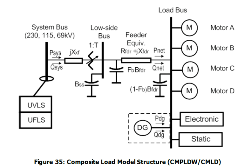

Good morning everybody.
Some grid stability studies neglect the demand side inertial contribution. Only compute the synchronous generators inertial contribution.
Other studies refer that, on the demand side, there are synchronous motors that must be considered.
The majority of electrical motors on the grid are asynchronous, induction type.
Do induction motors contribute to the grid inertia?
I know that if we install VFDs, they are decoupled from the grid and their inertial contribution is lost.
I didn´t find any document that addresses this subject so all your comments and expertise will be greatly appreciated.
Best regards.
Carlos Melim
Within the western portion of the USA, grid stability studies use a Composite Load Model that tries to account for dynamic behavior of typical loads, including the inertia of induction motors and the dynamic characteristics of VFDs. This model includes three separate polyphase motor equivalents to account for differing behavior of compressors vs fans vs pumps. Additionally, it includes modeling for single phase motors such compressor motors found in residential HVAC units. Including single phase motors has been quite important to studying fault-induced delayed voltage recovery (FIDVR).
In order to parameterize the regional model, each utility categorizes each circuit as rural, suburban, urban, industrial, residential, commercial, or a mix of these. For each of category of load, there are region specific estimates for the portion of expected loads (i.e. compressors, fans, pumps, resistance heat, VFD, lighting, etc) for each category based on the time of day, day of week, and season.
I think it is time to start building synthetic inertia into "smart" electronics, LED drivers, and perhaps some VFDs. Having TVs, computers, thermostats and lighting all start responding proportionally to frequency disturbances would be less disruptive than triggering entire substations to disconnect via Under Frequency Load Shedding (UFLS).

Induction motors respond to both the rate of change of frequency (i.e. inertia response) and to changes in steady-state frequency whereas VFDs always draw constant power. More detailed load models have evolved each time folks found that existing models failed to accurately predict power grid behavior. Within the WECC footprint, simple load models (i.e.% constant current, % impedance, % constant power) have little predictive value. Your mileage may vary when looking at other grids.
Going a bit off topic...induction motor behavior is also important when considering over-frequency events. For example, if the California-Oregon inter-tie trips off while Oregon generators are exporting lots of power to California, the northern Oregon island will speed up while the southern California island will slow down. BPA has a 1400 MW resistor to function as a dynamic brake to keep Oregon from accelerating too much. Induction motors with fan loads use more energy as the frequency goes up, so the fan loads actually provide negative damping to system.
Going slightly into the weeds... Although, I agree that induction motors very rarely export power except on rare occasions that the grid frequency declines very fast and very far (i.e. below 58.3 Hz), it is unfair say that motor inertia does not contribute to grid stability. Even without exporting power, high inertia motors actually start contributing to grid stability as soon a frequency deviations begins. As the system frequency drops, the slip will decrease and motor will temporarily draw less power from the grid.

A induction motor will reduce demand any time the frequency declines, even when the system frequency change is very slow. Think about a perfectly efficient motor driving a constant power load. At constant frequency, the power taken from the grid is equal to the power consumed by the load. When the frequency changes, the power taken from the grid is the sum of power consumed by the load plus the power accelerating the rotor. Granted, for a very slow change in frequency, the magnitude of power accelerating the rotor will be quite small.
For hand calculating a first swing on a small system, ignoring motor inertia for slow frequency changes seems like a reasonable simplifying assumption. For the WECC regional model that runs for more than 1800 cycles, this effect is built into the differential equations the computer simulates.
