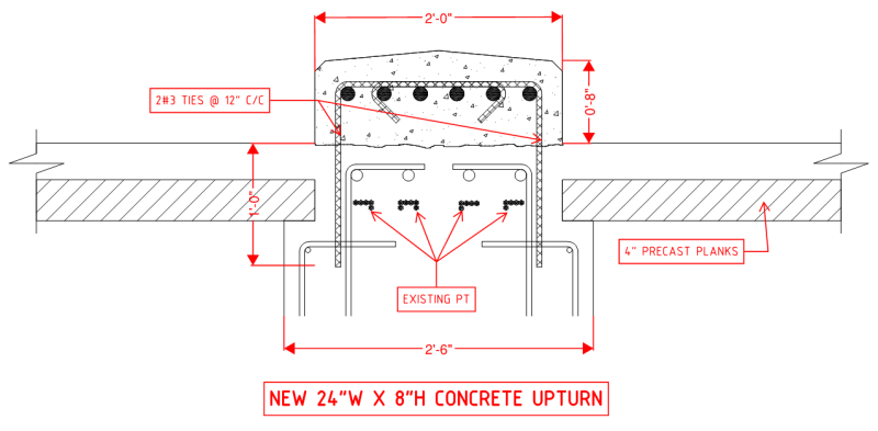

I have existing (30+ year old) 2-span PT beams (5'0" deep x 2'6" wide) that requires significant strengthening over the interior support (negative moment) for additional loadings for a proposed roof recreation deck.
The upturn can be integrated into the completed rec deck as a new pedestal system (of several feet in height) will be provided.
I have used ACI 318-14 to check horizontal shear transfer (composite action of existing beam to new CIP upturn) for a magnitude equal to the total tensile capacity of the added rebar.
I checked interface shear and shear reinforcing is required, via shear-friction across an intentionally 1/4" magnitude roughened joint of 24" width.
I have used only #3 reinforcement to assist with a reduced straight bar development lengths (ld=12" for #3) into the existing concrete (via epoxy etc), and #3 also results in a reduced hooked development length (ldh=6.5" for #3) above the interface.
I would usually detail a third row of reinforcement down the centerline of the beam (across the 24" upturn width), HOWEVER, there is existing PT tendons that I wish to avoid drilling through, so I only have 2#3 over the 24" width.
Any thoughts/comments of the following detail WITHOUT a center row of #3 interface reinforcing?
I don't see a third leg being needed in negative moment areas where the new bars are in tension. Locating the dowels might be tricky. You not only want to avoid the PT but also the existing stirrups. The stirrups are needed the most in the negative moment areas. It might be worth digging down occasionally to locate the existing stirrups to confirm their width.
With shear friction, doesn't the bar need to be developed on either side of the joint? Will that be possible given the edge distance to the precast planks?
All of your post tensioning has already been installed, so while this will put the existing concrete into compression, there's no way for that force to be transferred across this joint - either with or without shear friction. Are your top bars being designed for the entire negative flexural load? Or are you assuming some sort of load sharing between the existing beam and the new reinforcement?

Thanks for your comments. I will use just 2 rows of dowels.

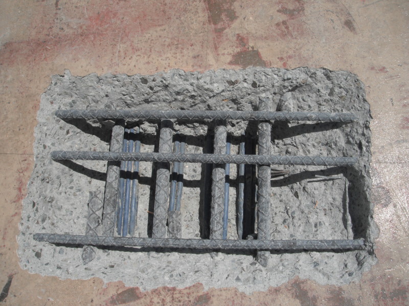

We have done one invasive probe (see below) and plan on a few more probes, following GPR scanning of the areas.
Yes, the #3 shear dowels will need to developed both sides of the roughened joint - which for 5000 psi concrete works out to be 12" for straight segment, and 6.5" for the hooked segment.
The precast plank bears within the CIP beam by 3", and the #3 dowel hole will be approx 2" from the edge of plank, or 5" from CIP side face, which I think will exceed edge distance requirements.

In my opinion, interface shear is the wrong way to go about this. Rather, the problem at hand is the fundamental detailing requirement for your shear reinforcement (existing) to make it to your tension reinforcement (new). Without that, our truss model of concrete shear is shot. Naturally, there's a horizontal shear concern as well but, with the vertical shear properly resolved, the horizontal should be self solving as it is in monolithic concrete.
The form of the solution would be similar save a few modifications:
1) you'd need to provide dowels for the peak shear demand rather than averaging the demand over the length of the reinforcing bars. Just as with normal stirrups.
2) you'd need to go deeper with your dowels as the goal is to not merely develop them but, rather, to lap them with the existing stirrups as extensions of those stirrups.
3) You could get away with just standard 135 corner hooks at the tops of the dowels as we do with other stirrups. Perhaps a little more constructible. I still favor some candy canes across the top, however, to help with tension load spread across the width of the beam. Cheap insurance and you'll need carry bars anyhow.
As for the centre row of interface dowels, I would argue that they would be largely pointless unless there was an existing stirrup leg in the middle for the dowels to lap width.

Agree. Using the "alternative method" of ACI 318-14 §16.4.5, we segmented the total "1/2" strengthened length into multiple segments and used the ΔM over each segment lengths (and therefore the corresponding ΔT in the rebar) to calculate the shear demand and calculate the required shear-friction dowels over each segment.
I agree that a LAP length (not DEVELOPMENT length) is required under 'normal' conditions, but the beams have been already been strengthened for vertical shear over their existing 60" depth using FRP. So my thoughts (right or wrong?) are that if there is sufficient vertical shear capacity (based on the existing reinforcement plus supplementary FRP strengthening) then provided that the added NEW longitudinal rebar forces can be developed across the interface, then all is good. Lap splice length is only 1.3ld so maybe it is indeed best to drill and dowel a little deeper.
Our '2nd iteration' details amended the details to that posted above - changed longitudinal bars into 2 layers, and also changed the hook details, somewhat similar to what you suggested.
