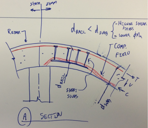

I'm going to look into this a bit more too as it is also what the rail supplier recommended. Unless I can get my hands on some unusually detailed output, however, I'm not sure how convinced I would be by a positive result coming from the software. If the supplier engineers themselves can't tell me whether or not the stud rail height matters, I have limited confidence that the issue is properly addressed in their software. For all I know, the program may just check code specified stud heights and base the reported capacity on Vc and Vs with no specific regard for the stud height. We'll see.
Quote (sandman)
but doesn't the shear stress increase with the smaller depth along with giving a smaller I increase the stress even more.
If I understand correctly, I agree with this. See the sketch below. In this regard, I would much rather have maintained the top cover as opposed to the bottom cover. That way, I might have a reduced effective flexural / shear depth but at least I'd have convincingly engaged the tension steel.

The supplier response to all of these items is essentially this:
When we study this in section, we tend to imagine that the rebar is in the same vertical plane as the the studs. And that isn't necessarily true. In general, there will be a plan offset between the tension rebar and the stud heads. At least, to my knowledge, there is no requirement for the studs to align with any of the individual reinforcing bars. They often seem to as a constructability thing but, even at that, it's not as though you are engaging all of the tension rebar right at the stud rails.
Two consequences of this:
1) A complete strut and tie model of the situation would need to incorporate some struts running upwards and laterally, in plan, from the bottom of the rail studs to the rebar at the top of the slab. And where those struts would hit the top of the slab, there would generally be no vertical reinforcing there to pull the force back down to the bottom of the slab.
2) Even with proper height studs, there's still an unreinforced, "concrete in tension" plane existing in the load path.
Another reason cited for this not be a strut & tie thing is simply how the design checks are set up. They mimic conventional beam shear checks. Of course a) this is simply reflects a choice rather than a limitation and b) conventional beam shear checks are based on the truss analogy anyhow which echoes strut & tie in many ways. So maybe this objection is bull.

So... having synthesized a great deal of information on this subject, including that which you all have graciously provided, I've decided that my solution here will be "do nothing". For those who remain interested, here's where I'm at with it.
1) While I truly hate to see a very bad deed go unpunished, I won't specify a onerous fix for any reason other than technical necessity. And my gut feel conclusion here is that a repair is not a necessity from a technical perspective.
2) I've researched stud rail code provisions, Hilti punching shear repair provisions, and simple ACI/CSA beam shear code provisions going back to 1971. They basically all say the same thing.
- Do extend shear reinforcing as close to the tension and compression faces as possible.
- Do whatever is in your power to convincingly anchor shear reinforcing at the ends.
That said, there are relatively few situations in modern shear reinforcement design where shear reinforcing is truly developed or anchored a) entirely within the compression zone or b) beyond the tension rebar. In general, we seem to accept this as the way of things and, to my knowledge, there have been no consequences. So, to some extent, the stud rail supplier is correct in that our efforts simply constitute a "stitching together" of things.
3) Initially, I had great concern for the potential of an appendix D style anchorage failure at the stud heads. The Nelson stud design manual (clip below) indicates that 8-10 stud diameters worth of embedment is required to prevent that. That would have meant for a minimum 6" stud in my case.
I see now that I was viewing this incorrectly. The upper heads of the studs are able to push back against a concrete strut which significantly alters the character of the problem such that an "anchorage via concrete in tension" interpretation is not strictly valid. I've tried to illustrate this in my sketch below.
4) In the sketch below, I've indicated a zone of perpetual pain and anguish (ZPPA). The ZPPA seems to be, for the most part, where our concerns lie. I still share those concerns but, based on my intuition and free body analysis of the situation, I'm confident that the issues within the ZPPA are sufficiently minor in nature that they can be set aside.
Interestingly, the FBD below provides a qualitative means of assessing the "when is short too short" question that has haunted me. The low stud heads result in something akin to a transverse flexure demand in the concrete struts when those struts are imagined as little beams. Obviously, the shorter the studs, the closer their tension loads are delivered to the "beam" mids-spans. And that means more bending moments and a higher propensity for failure.

Thanks for the input cliff. I share your concerns if not your final conclusion. In response to a couple of your comments:
1) Above, I mentioned the case of a non-prismatic slab (quoted below). It seemed to go under the radar with the group here but I find the example quite salient. In plaza and parkade slabs, having a slab top surface slope that differs from the soffit slope is a common occurrence. Depending on whether or not the designer chooses to slope the top rebar to match the soffit or the top of the slab, a situation may be created where even proper height studs will not make it to the tension steel. A mere 2% difference in slope would be enough to create a 25 mm shortfall at the end of a common length rail. I take this as anecdotal evidence that it is in fact a relatively common occurrence to have less than full height studs. And, to my knowledge, there have been no consequences to that.
2) In Canada, our integrity reinforcing provisions for concrete require us to install integrity bottom steel at all columns to provide a secondary path for punching shear. In that respect, we do have some forgiveness at the ULS condition.
