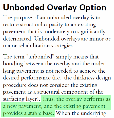

If the existing slab is in good condition, I would not bond the two slabs together. In fact, I would provide a polyethylene sheet bond breaker between them and maybe some wire mesh for shrinkage reinforcement.

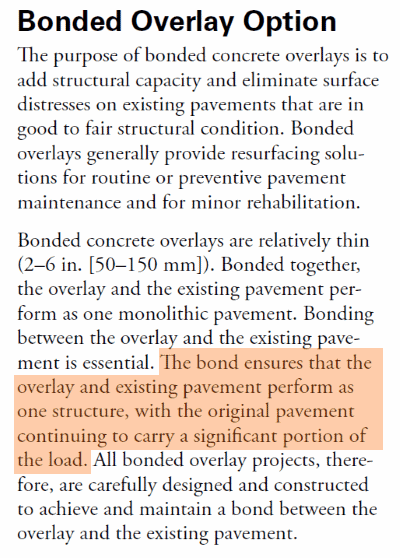

bvbuf - Per Dik's comments, the condition of the slab is most important. A 4" thick existing slab may be too thin to survive surface preparation for a bonded overlay.
If the full strength of 7" inch (bonded overlay) slab is not needed, a 3" unbonded overlay should work.

bvbuf said:
I'm not sure if that is what you mean by " the full strength of 7" inch (bonded overlay) slab".
With a bonded overlay, the concrete (should) perform as if it was at 7" thick monolithic slab:
Page 2 of the "Guide to Concrete Overlays"
An unbonded overlay is expected to perform as a 3" thick slab that is supported by really good base material (the existing 4" slab)
Page 3 of the Guide
A 3" (unbonded) slab is pretty thin, even on good base. Is that good enough for this project... maybe, that's your call.

I dug a little through the reference by SRE but found no method on how to bond the new to the old. My experience with this method has found it to work well. You roughen the old surface with jack hammers or other tool to get rid of any weak concrete. Vacuum off all the dust. Make sure that old surface is BONE DRY! Have your new concrete layer batch on hand ready to apply it to the old. DO NOT WET THE ROUGHENED SURFACE. Now brush on a Portland cement paste of cement and water at the consistency of cream. Work it into that roughened surface. Then add your new concrete mix immediately. Moist Cure with surface covered for 7 days minimum. Later take a few cores to see how well you did. Use a chisel and see if you can break the core at that bond. My bet is it will break elsewhere.

to engage the horizontal shear, from flexure, and, provide added strength and stiffness.
