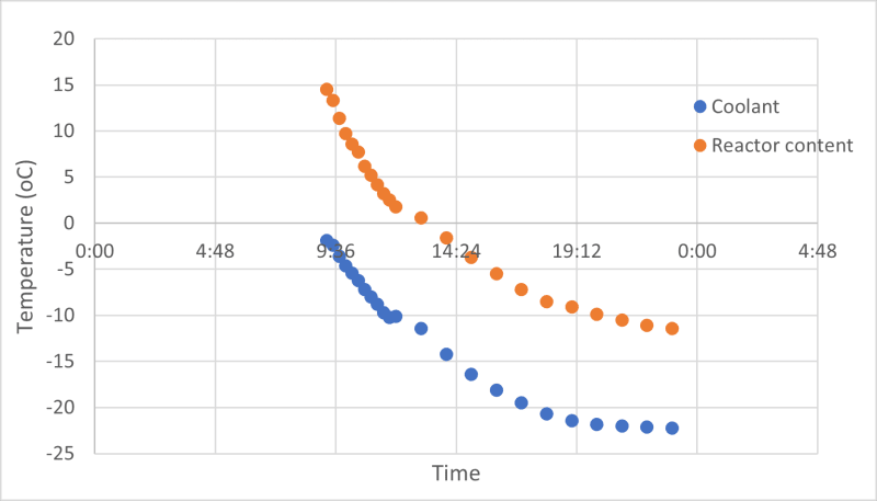

Hello,
I have a mixing tank 1.7 m3 half covered with plain cooling jacket (heat transfer area 2.44 m2).
I tend to use the mixing tank for a reaction that is exothermic (ca -10kW), for that reason I want to check if cooling duty of chiller and jacket is sufficient.
We carried out some tests and the results showed that jacket had a cooling rate of 2.3 oC/h dropping temperatures of the reactor content (400L) from 15 to -10oC in 11hours. That seems extremely slow.
Notes:
[ul]
[li]Reactor content: 400L of 30% IPA[/li]
[li]Reactor size 1.7 m3 and filled to 0.4 m3.[/li]
[li]Tank contents were mixed during cooling and process was batch.[/li]
[li]Jacket was insulated, pipes of 4 m were not insulated.[/li]
[li]Coolant: 50% glycol[/li]
[li]Coolant rate 38 m3/h[/li]
[li]Coolant initial temperature -2 oC and cooled down down to -20 oC.[/li]
[li]Coolant buffer 1 m3 was used. The coolant was circulated from buffer to chiller to jacket and back to buffer.[/li]
[li]Jacket coolant velocity is 0.2 m/s (seems low).[/li]
[li]We found out that chiller has a cooling duty of 12 kW at temperatures input of 15oC and drops to 5 kW at temperatures input around -5 oC. It showed that cooling duty decreases as temperature input to chiller decreases. Kind of makes sense.[/li]
[/ul]
Then we tested the cooling efficiency of the jacket, showing very bad results, of cooling duty ranging from 2 kW (at temperatures around 15 oC) to 0.3kW at temperatures below 0 oC. This duty was calculated measuring the temperature content of the reactor over time, taking into account the mass and specific heat capacity of reactor content.
The temperatures input and output to the jacket were measures but due to calibration errors they were not showing any reasonable temperature difference to be used to calculate duty. In order to get such a low cooling duty the temperature difference should be around 0.01 oC.
In order to understand if this is reasonable, I calculated the U-value of the cooling jacket. I used the following tool: CheCalc ‐ Jacketed Vessel Heat Transfer and I came up with a U of 140W/m2 K (quite reasonable for a cooling jacket).
The effective heat transfer area of the jacket was measured to be 2.44 m2 (the liquid in the reactor was touching half of the cooling jacket. With an estimated LMDT of 10-12 oC (that is the difference throught the tests between cpolant input temperature and reactor temperature), the estimated duty was calculated at 3.42 kW. So I don't understand why in reality the cooling of mixing reactor is a lot less efficient.
You said your coolant in the jacket goes down to -20 C. 30% IPA in water freezes at -15 C. Pure IPA also gets viscous as it approaches freezing point - I'm not sure if a 30% solution will do that as well.
You have two possible issues:
[ul]
[li]Your batch is thickening as temperature drops - test this out in a lab to determine viscosity vs temperature.[/li]
[li]Your heat transfer coefficient is wrecked when your jacket temperature drops to -15 C or under, as you will begin to thicken, then freeze, at the jacket wall. If you can, try setting minimum jacket temperature at -12 C to see if this improves performance.[/li]
[/ul]
Based on your number provided it seems pretty clear that as you get colder, the contents of your vessel are inhibiting the transfer of heat from the majority of the fluid through a thick viscous / frozen layer on the wall of the vessel. So you need to scrape the wall and get some good circulation going.
The flow of cooling liquid could also maybe improved, but without a photo or sketch difficult to see what is going on.
Without adding either fins ( which will probably clog up), or cooling pipes within the vessel itself it is difficult to see how to improve things.
Maybe circulate some of the liquid through the coolant in pipes, but again if it goes viscous that may not work so well.
This is the cooling rate profile. The duty decreases as temperature decreases and probably is due to loss of thermal coefficient on the wall. However, at over 0oC we can still see that the cooling duty is quite low compared to chiller duty of 10kW.
Even at 140 W/m2/K you only seem to be about 3.4kW. I think 140 is quite high and hence to get omre you either need to raise that somehow or increase the area.
There is definitely a drop off in cooling rate below 5C in your vessel.
Based on the actual experimental data, U-value is at 41 W/m2 K. Is this reasonable for a cooling jacket?
KangCy,
41 W/m2K is very low for normal heat transfer in a jacketed vessel. I've seen 300-500 W/m2K in a clean application for heating or cooling water (both vessel and jacket mediums are water). For high viscosity batches, I've seen this drop off significantly to perhaps 100 W/m2K for viscous batches (5,000-15,000 cP). Your "U" value seems quite in line with thickening/freezing causing a "foulant" layer on the Hx surfaces.
Multiple posters here have noted the most likely cause is thickening/freezing at the vessel wall, and have also suggested the most common solution. You haven't addressed their suggestions, as of yet. Is that solution not acceptable? The other alternative is not cool down so far on either the jacket or vessel side.
Changes to equipment is not possible due to budget. And pilot plant test is coming up soon. That's why change needs to be in process conditions.
