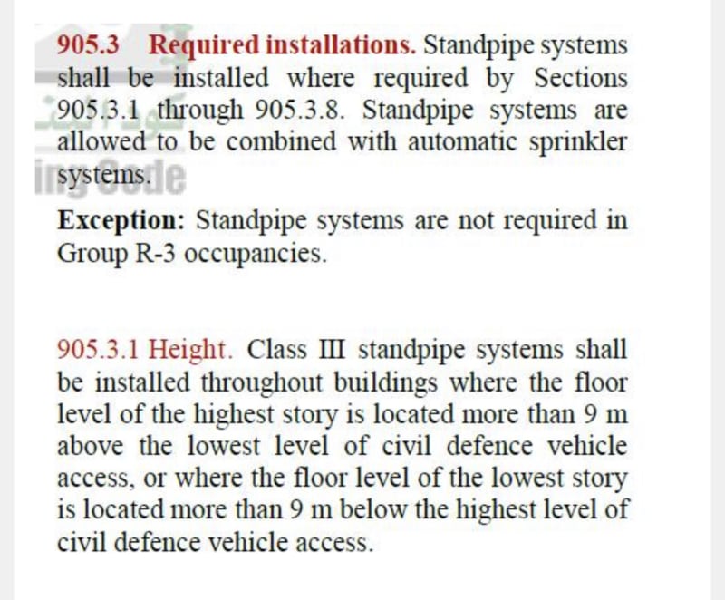

Saudi Bldg Code , IBC , 2018. Where standpipe is required.
I think it's an answer to the closed thread referenced.
