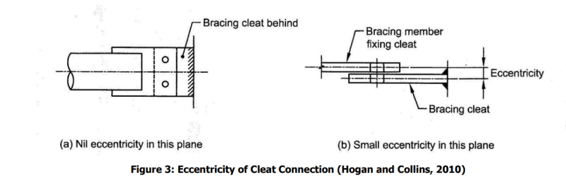

As described in the pdf linked. You really need to read the first couple of pages of that or THIS to understand the background and the issue.
I use these connections extensively and am aware of the eccentricity issue so testing this was part of me running IDEASTATICA through its paces. It didn't pass, but I'm currently putting that down to user error[until I have the chance for further testing. The software seems robust and reliable, but it is only as good as the operator.
To model it properly you probably need to remove lateral restraint from the compression member and manually change the location of the load application. That is the good thing about guides, they hopefully should capture ALL failure modes. Modelling software like IDEASTATICA can readily not capture some failure modes unless you specifically go hunting for them. EG try to get this compression failure mode happening IDEA:

And it turns out that my 'test' earlier has already been verified by IDEASTATIC. And no surprise IDEASTATIC works, like I expected user error. Me. But it does highlight, like most software tools, that you need to be very diligent in the your configurations, assumptions and boundary conditions.
Though in this case of the verification approach they used the eccentricity force has to be added manually which is not at all intuitive for the user of the software. I'd have expected that the IDEASTATICA would have incorporated that. Evidently it doesn't regarding bolt/plate interface eccentricity.

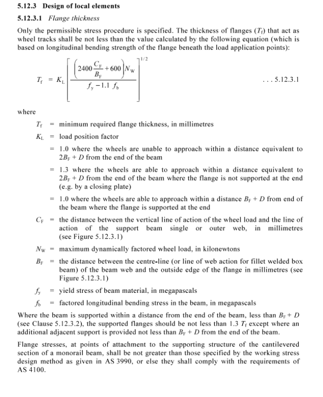

When I design monorail beams this is the formula I use from the code based extensively off empirical testing apparently:

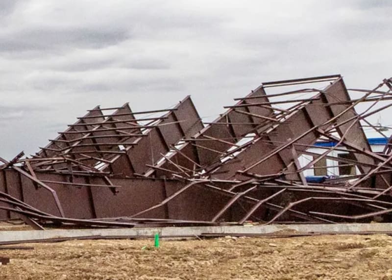

I wasn't meaning to have any comment on portal frame knee braces. Which I have never used, have rarely seen use (except in a negligent engineering project I'm currently reviewing as a third party)**. I have often used them on small platforms that have minimal lateral loads and need some bracing, but I'd normally choose angle for that.
**A 20m span portal frame industrial shed with C30024 columns and beams. Those are cold formed members that weigh 10kg/m (6.7pound/foot). It is an impressive piece of engineering if you live in a place where wind and snow doesn't exist.
