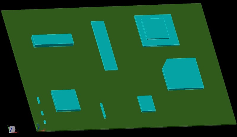

This journl is based on a journal I foun in the internet
I want that the Z-Axis to be aling with face normal
bat some run its ok and some run its not OK (Z-Axis Not to be aling with face normal)
can some one help.

This view show the WCS at the left bottom corner.
when I rotate the brd to see the other side of brd.
Here is the other side shown here.
My gole is when I select this face the journal don't work
Thank you in advanced.
I posted the brd
to play with
move the WCS to somewhere not in corner then run the journal and select the top
face and the WCS will move to the corner and the WCS Z-Axis is align with face normal.
now rotate the brd to see the other side face and again run the journal and
select the other face now the journal not works as expected.
Thanks.

I changed origin2 as shown here
but still the WCS Z-Axis don't align with face normal.

Hi, as far as I know WCS is accesible only by Displaypart and not Workpart. I didnt have any luck to access WCS orientation matrix in Workpart CSys. Only origin.
Try to change your code to displaypart.WCS instead of workpart.WCS.
Hi wizdar you right.
I'll try it.
Thank you very much.
