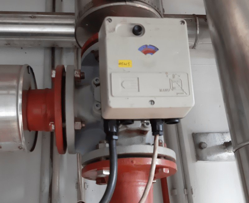

I don't understand the position and function of this three-way mixer 1

This is the situation:
For clarity, this is a P&ID sketch of part of the same manifold:
I don't understand the position of the three way mixer, as this would mix hot water into the return and serves no function to control the heat of the flow to the HX - it could limit flow to the HX but this does not make much sense energetically (especially considering the cogeneration plant) There's another three way mixer installed near the boiler that could ensure a minimum return temp.
I also miss one-way valves at the pumps.

Looks like a diverting valve - not a mixing valve. Flow enters the bull of the 3-way and then goes either up or down depending on the valve position, correct? Is the valve 2-position, or does it modulate (I'm guessing 2-position)? I can only assume it is used to prevent the pumps from dead-heading if control valves at the load are closed.
This is a closeup of the valve:
... appears to modulate and be set roundabout the middle position when I took the picture.
So flow is entering from the side and leaving from the top and bottom?

It appears to be a temperature control. Hot water comes from the left side, cold water comes from the bottom thru your red line (which I think should be blue) and the mixed water leaves thru the upper discharge pipe.
For temperature control, the 3-way valve would have to be on the suction side of the pumps.

So to ask my question again, am I correct that the water is entering the valve on the side, and exiting the valve from both the top and bottom ports?
So it is diverting part of the flow from supply to return. The question is, why? Where do the pipes on the bottom-left side of your sketch go? They must go back to the heat source. Can you provide more information?
Yes the pipes go back to the heat sources. As for the why, that's what I'm trying to find out here, maybe one of you has seen such a system. Or the operators are after all able to provide me the control narrative.
Ok, I can't much more than speculate at this point. Two reasons to take perfectly good hot supply water and dump it into the cold return would be:
1. To protect the pumps. If the control valves at the load close, then the pump will dead-head. Opening the diverting valve would remedy this. In that case, it should be operated on pressure or flow.
2. The heat source is a non-condensing boiler and the return temperature is too low. Intentionally bypassing hot water into the cold return will prevent unwanted condensation. In this case, the valve should operate on temperature going back to the boiler.
You need to find out more. At some point, you may want to close the manual valve on this bypass line to see if there are any adverse effects. I would do more investigation first, however, because there may be a good reason for this piping arrangement. You don't want to shut valves without understanding the system, but I have found unnecessary bypass valves open before.

It is diverting, pay attention to how things are piped in relation to the pumps.

My assumption is the following:
The mixer served to control the flow to the HX while keeping a constant flow through the boiler, the boiler would operate in on-off mode.
At a later stage, the CHP was added. At the same time the hydraulic ompensator and the return-boost and boiler feedpump was added because the old control scheme didn't make sense with two heat sources.
Presumably the mixer is still used to control flow to the HX since there's no other way to do so (I could maybe test this by analyzing data from the PLC or SCADA, if the valve setting is recorded).
What I still don't understand is why use two pumps without check valves (for redundancy of this critical part).

It's certainly the recirculation/return (as i've written seomwhere upthread but noone rereads the whole thread every time they post :)), but since the HX is a 24/365 heat consumer I don't think the rest of your reasoning applies.
on the basis of that information it looks like it was there to ensure a constant flow through the (single original) boiler regardless of flow through the heat exchangers. This functionality has now been included in the boiler pipework itself, though will a slightly lower mass of water.
So on the face of it you could just isolate that line and see what happens. I suspect very little of note except you might have a little more pressure available to your HX's.
As said before you need to see where the control input is coming from to drive the modualting 3 way valve. If you can't find out then may be one by one take the output from the meters and try and provide different values from that being supplied.
Or little by little screw down the isolating valve next to the blue valve ( looks like a globe type valve to me) and see what happens.
