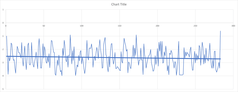

Here is averageifs() with a 1 mm bin and a linear trendline added to that.

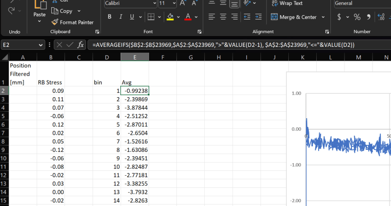

Spreadsheet attached[URL unfurl="true"]https://res.cloudinary.com/engineering-com/raw/upload/v1676938363/tips/Data_Sample_dh4jmt.xlsx[/url]

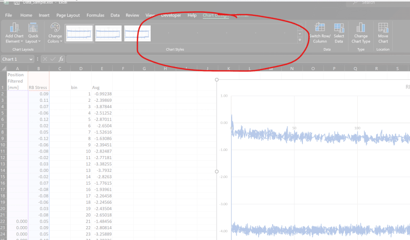

I'm not able to add the new series to the OP's original plot. Anytime I try Excel goes unresponsive while it tries to preview every possible style for the chart. Any idea how to get around that?
Thanks MintJulep, I wasn't able to get the criteria working inside the Averageifs formula, maybe because I wasn't using VALUE().
I think I also had a problem with selecting the original graph. I'll have another look later.

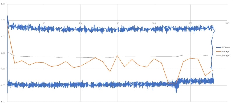

I had another go at editing the original graph, and this time it worked!
I have added two lines:
Average 1 is the average of all the data, divided into 10 unit wide bins. I think this is misleading because it seems there are many more data points on the lower line than on the upper, so the line is skewed downwards.
Average 2 is the average of the 2 lines (>= -2 and < -2), equally weighted. I guess the average of the average 2 line would be a reasonable estimate, or you could fit a straight line to it if required.
