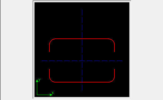

structSU10 I'm admittedly not familiar with this portion of AISC does the ineffective length apply across the HSS wall such that you get an effective weld group per below, due to the flexibility of the wall under the perpendicular loading caused by the moment?
Open Source Structural Applications:
It depends on the branch type it can be considered - basically the forces applied at the joint. What you show is applicable to some branch types, and i think it is applicable to your situation, but it may not apply to all branch types. I believe RISA is reporting the ineffective length based on these equations.
