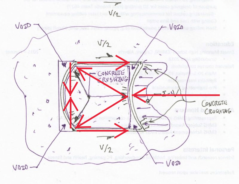

Hi
I have a HSS shear lug. Inside of the tube is filled with grout and 2'' outside tube as well. Regarding the failure modes of the shear lug tube, local bending of the flange is not a failure mode as the tube is infilled with grout. Any comments?
sail3 said:
the face of the HSS has no significant stiffness compared to the sides
Yeah, that. You dun speak KootK goodish.

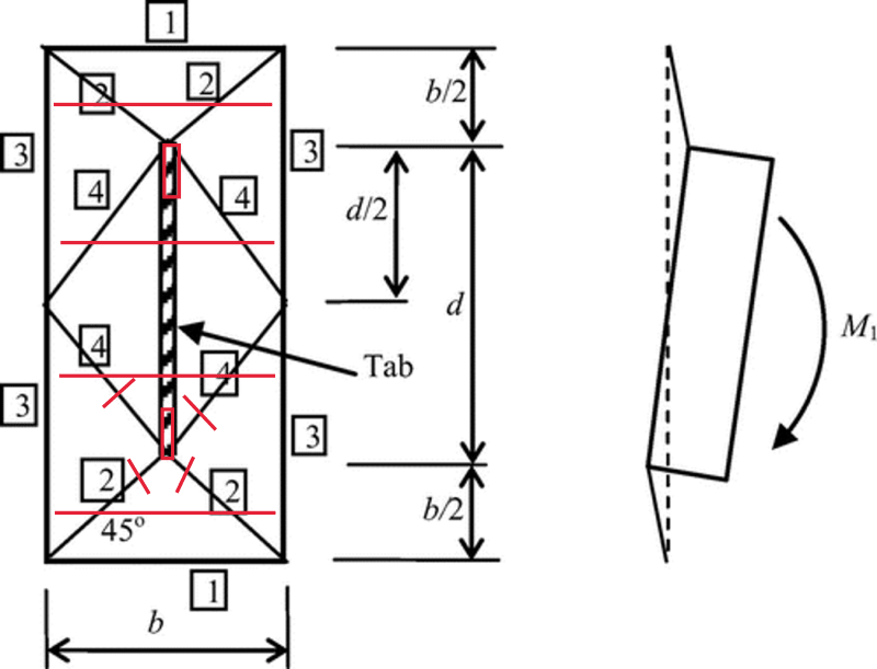

It occurs to me that there is a very good analogy for this situation: the mundane column base plate.
1) You get serious hot spots.
2) No way in hell they work without some local concrete crushing and redistribution.
3) We design them by preventing flexural plastification and this seems to work somehow.
Bones said:
So my argument is not to worry about the HSS face bending because by then your shear lug is already gonna be having performance issues.
Okay. But this is very much like saying that we ought not worry about column base plate bending because by then we'd already be having grout/concrete performance issues. It's true but it's certainly not the conventional approach.
Bones said:
If you use KootK's free body diagram and assume a narrow bearing width (maybe 2x wall thickness) at each the HSS walls parallel to the load, you could probably make a reasonable estimate of the bearing pressure on the surrounding grout and compare to an allowable.
I agree that this would be a valid approach. Interestingly, there's a column base plate design method for lightly loaded base plates that works pretty much the same way: Link.
My beef with this method for this application is that it's highly unlikely to work out in most practical scenarios. In my experience, folks in the wild are sizing these things for monster loads and need the entire HSS width to get it done. OP can correct me if I'm wrong but I believe that we're talking about an HSS 10x10 here and about 500 kip. No 2x thickness is going to move that kind of load unless the key is 4' long.

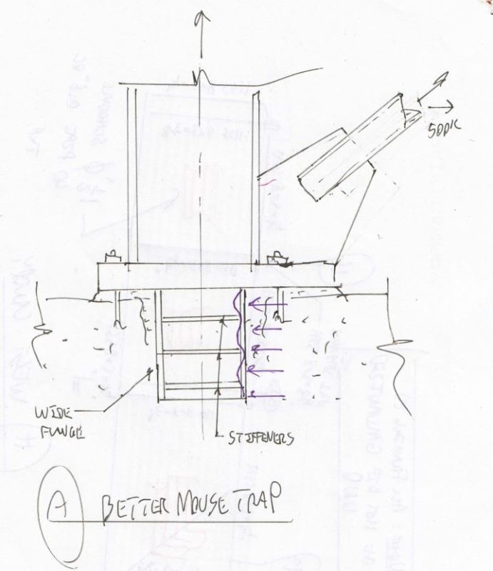

In the interest of being constructive, I think that something like this would be a much better choice for serious, woman sized loads. Again, not dissimilar from what Blodgett has us do for monster column base plates. Just sideways.
@KootK Yeah the loads are pretty high. They are in range of 500-700kips. The tubes are close to 12''x12'' and are 2.5' long. So bearing capacity is 0.55 x 5ksi x 12 x 30 = 1000kips. Minimum width of tube I need to resist the load in bearing is 8'' assuming the bearing only on the front face. No way I can get 2 x thickness to get the shear lug to work in bearing.
KootK said:
If you're confident that you can get the grout in there you can, at best, split the load demand between the forward and rear HSS walls.
Maybe I will design the lug for atleast this flexural behavior. I will use wl^2/12 and the HSS wall spanning 'D-2xt'. This should not be difficult to achieve.

This is a monster load and a long lug. With your work point at the base plate and your center of shear resistance 15" below that, you're dumping as much as 875 kip foot into the system at the joint. The question becomes where to put all that moment. If it goes into the base plate and anchor bolts then that obviously complicates the anchorage design. If it goes into the column, then you've got to deal with it there. You'd need something to the tune of a W14x132 to deal with that moment on an Mp basis alone. You'd also want to consider the impact of that moment on the column base rotation if that's where the moment goes. You don't want your lug rotating along with the column in such a way that your lug bearing stress distribution strays substantially from a uniform distribution.
Dont we design the shear lug and the lug weld connection for that eccentricity? Assuming uniform bearing on the face of the lug and considering the moment arm from the center of the lug to attachment?
how wide is the base pl...a sketch would help....monster load
We do design for those things but they don't eliminate the moment imposed by the key on the joint that I mentioned in my previous post. They're just part of the load path that delivers the moment to the joint.
