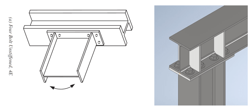

Ran into a connection I haven't seen. Doing a re-rate on a monorail structure. The picture is of the type of connection used on one side of the monorail to column.
Would you classify this is a partially restrained moment connection? It's sort of inverted since if you flip this 90 degrees, it's a standard column to beam moment connection.
Thoughts?

Yeah, it seems reasonable to assume that connection was designed to transfer moment since one wouldn't normally go with an eight bolt pattern otherwise.
Looks like a bolted end plate moment connection to me. This would be considered a fully restrained moment connection. AISC has some designed guides on the subject.
I would consider that to be a fully restrained moment connection. You're right that it's identical to a standard beam to column connection, just rotated 90 degrees and the connection doesn't care about its orientation.
(The picture on the left is from AISC's Design Guide 4 - Extended End-Plate Moment Connections)

Thanks guys. I guess I was just questioning if the beam would still effectively transfer the moment with not having the top flange also restrained (like a normal beam to column connection).
The stiffeners are doing that the job here.
The moment connection doesn't know which way is up/down/left/right and it doesn't know where the moment force is coming from. If the beams/columns are the same member then the connection is analogous and symmetrical to you typical beam column moment connection.
** I said "moment force" because clearly the axial/shear forces are different per member.
